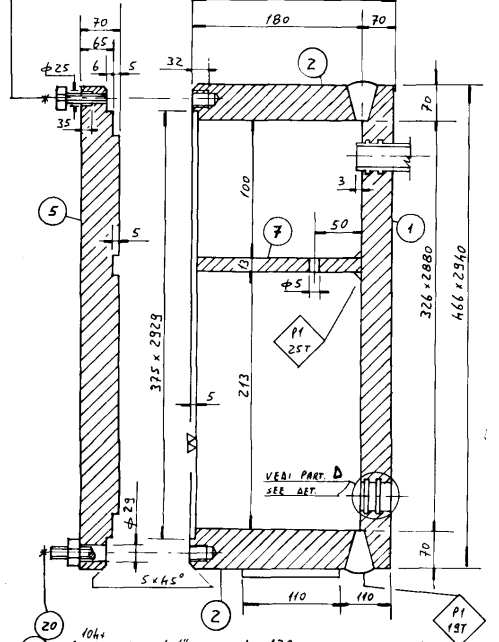

I'm performing an analysis of an Air Cooled Heat Exchanger with Flanged Cover on SolidWorks Simulation.
Due to the flanged cover I have to impose a contact interaction between the plates of the air cooled and the flanged cover, that took much more time than a bonded contact simulation.

1. SolidWorks Analysis Solvers:
2. Shigley's Mechanical Engineering Design, Chapter 8.
Pressure Vessel Design Manual, Deniss Moss, Chapter 3.
3. Use shell elements if its possible.
Use symmetry and sub-modelling of the closure and shell.
