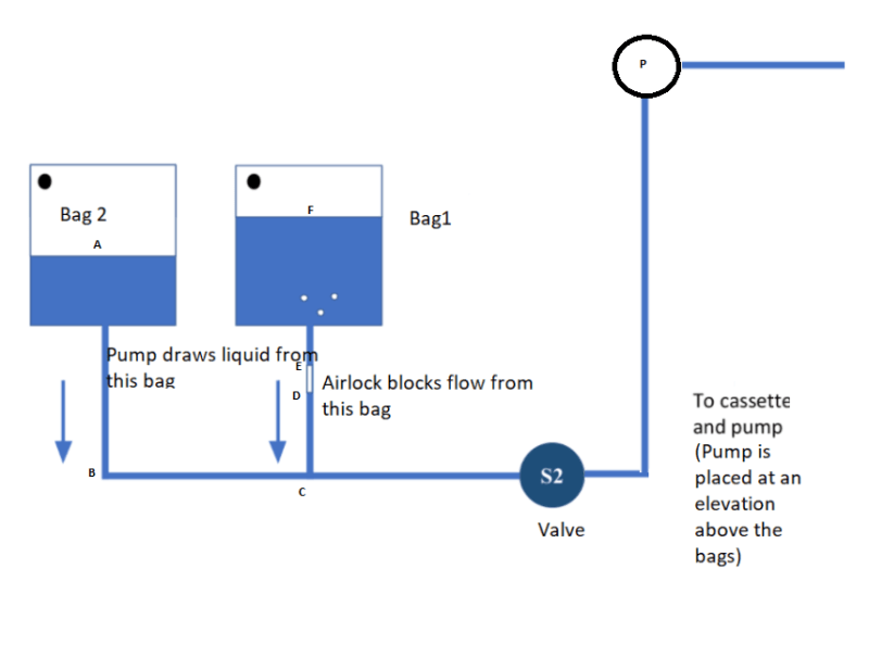

Hello all,
I'm working on improving an existing system that consists of 2 water bags hung on an elevation below a peristaltic pump. A single solenoid valve controls the flow through both tubings (Image attached).
1. Upon repeated operations of this arrangement, we observed that an airlock locks flow from one bag (bag 1) and the pumps starts to draw liquid from the other bag only (bag 2). This is opposed to our intention of equally draining the bags.
2. Also, we have observed that as liquid level in bag2 falls (because of fluid flow), the airlock ultimately gets sucked into the pump system and discharged. This is good news but the airlock shouldn't have occurred in the first place.
The issue is that our machine software is built on the assumption that liquid will be drained from the bags approximately equally. Also, with this bag arrangement, we believe the machine's mechanical behaviour has become unreliable since sometimes when the airlock doesn't occur, the bags are indeed drained equally.
We have decided to change the pump suction arrangement entirely to bypass this problem and added an intermediate bag for deaeration purposes. However, my seniors are demanding that I give them a reasonable physical explanation of the issue and its causes before we change the design.
Air coming into the tube is no problem and is an expected occurrence. However, airlocking is an issue and I have not been able to come up with a good explanation. I understand that airlocking reduces the elevation head of water (height of airlock * water density* gravitational acceleration [rho*g*h]) from the airlocked bag at the junction but why can't we simply suck out the problematic airlock?
Any help will be appreciated. Please note that the pump is above the bags and liquid under question is water.

Air lock occurs where there is no pressure difference across the bubble.
With no pressure difference in a branch between any two points in a branch, flow in that branch stops.
In the diagram I copied ...
Head from A to B - head from C to D is equal to the head from F to E.
The pressure immediately above the bubble = the pressure immediately below the bubble
(assuming the bubble weighs next to nothing).
When there is an air bubble at DE, the head from bag 1 acting at C is "neutralized", it is already balanced at D with the head from A to D, so only the head of bag 2 controls the pressure at C. As the level of bag 2 decreases, that lowers the pressure at point C.
When Bag 2 empties enough to reduce the pressure at C to a lower value, such that head AB - head CD is less than head FE, flow from bag 1 will start again. Lowering the elevation of bag 2 may also help keep the pressure at C a little lower, thereby enabling a little more flow from bag 1.
You might improve the performancemance if you can move the connection point C to the valve and put the valve immediately adjacent to the pump. No guarantees. You might also improve the performance by lowering the pump as much as possible, preferably below the level of both bags. It is possible that a larger pipe diameter, connecting bag 1 to D or C may help, but it may also drain bag 1 faster.
Contrary to popular belief, pumps do not suck liquid from the bags. A pump can lower its inlet pressure enough that the head provided by the bags becomes sufficient to move their contents to the pump. Lowering the pump, or raising the bags as high as possible will help.
Note: There may be some important capillary surface tension effects that I am ignoring in the above.

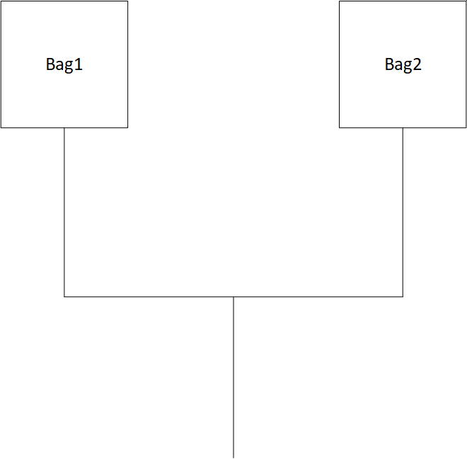

Have you tried putting the T between the two bags? Then, at least, you'd get bubbles on both bags, if at all.

If you want equal flow and emtying the same then you need to make everything as equal as you can.
As you've drawn it Bag 2 has more / longer tubing than bag 1. Now that may be the way you've drawn it but without dimensions we don't know.
If indeed those tube are actually vertical the only thing I can see to stop that bubble going up is that the tubing is too small and you're getting some sort of surface tension issue that is stopping it going vertically up.
Is your tubing all vertical? Do you have a picture?
Placing the pump above the bags ( how far above?) means your piping system may well be operating below atmospheric pressure, hence encouraging any dissolved air to come out. Can you lower the pump to below the level of the bags?

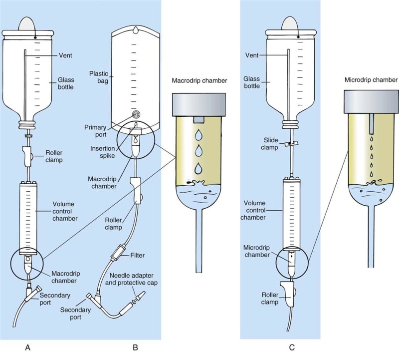

Approaches used in patient treatment:

(When there is an air bubble at DE, the head from bag 1 acting at C is "neutralized", it is already balanced at D with the head from A to D, so only the head of bag 2 controls the pressure at C. As the level of bag 2 decreases, that lowers the pressure at point C.
Means .really nothing more than the obvious.. no flow from bag 1, so it is essentially hydraulically isolated from the rest of the pipe.
Normally in a free flowing system, heads from both A and F branches are always balanced and correspond to liquid levels in the bags. If they were not, flow would start from one bag to the other and the liquid levels would move up and down until liquid levels in each were nearly the same and the final head at C would be the result of that interaction. Your diagram shows what should result in a high flow from bag 1, to bag 2, or to the pump, yet bag 1 is not flowing anything. That indicates the higher liquid level we see in bag 1 is not affecting flow to C, as is also indicated by the stationary bubble. If flow is not occurring in F-C, and the bubble is not even moving up and down even just a little, then the system is not "feeling the effects" of the head in branch F-C at all. If that is the case, the pressure at C must be almost only the result of the head created by bag 2 alone. The effects of liquid level at C from bag 1 must be much less than the effect of bag 2. Bag 2 is essentially controlling all action in the pipe to valve and pump.
You then see that happen, as the bag 2 level has to drop and greatly lower the pressure at C before bag1 pressure becomes greater and starts moving the bubble down..
Does that make sense now?
The zero weight of the air bubble and surface tension greatly reduce the effect of bag 1 fluid level to the pressure at C.

My suggestion will be, JUST WRITE ( SERUM INFUSION SET TUTORIAL ) and search the web to see the flow mechanism .
One of the possible outcomes ;
Apparently you need drip chambers and clamps to controll the flow..
That's what I was thinking of ... like the "microchip chamber".
Even with the drip chambers - nursing staff have to smack the upper part of the tubing to force a bubble to move. The drip chamber simply means that no bubble introduced into the bag can easily migrate further.
I imagine so, but it shouldn't need to move, if the fluid is passing by. A bubble trap should help.

Note the roller clamps in the above diagrams. These are used to sweep bubbles through the system upon initial set-up.
