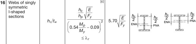

1. I believe it can, but I don't have sufficient evidence/use history to back that up. I'm assuming your shape looks like the below section. For rows 696-700 I would suggest entering those for the original WF only. The remaining section properties (Ix, Zx, J, Cw, Iyc, Afc, etc.) should capture the built-up WF + angles. You'll definitely want to manually-enter the optional inputs for Cw, Iyc, Afc, Iyt, and y_stiff to define that type of shape because your flange properties will be very different. If the reinforced flange alternates between compression and tension, you'll probably want to check it as two separate member in the spreadsheet.
This ties a bit into question 2, but for this type of shape, I think you'll want to enter a value for y_stiff to capture the smaller h because the angles stiffen the web (see "h (new)" below). y_stiff is a "pseudo" property I came up with to try to capture scenarios like this where a reinforcement shape is added that reduces the stiffened height of the web. If the reinforcement isn't full length, then tread lightly.
2. AISC requires the use of hc/tw to check the compactness of a web subject to flexure for singly symmetric I-shapes per Case 16 of Table B4.1b. See below. hc can be greater than h. hc increases when Sxt > Sxc and decreases when Sxc > Sxt. My spreadsheet checks that for singly symmetric shapes, which is triggered by an "if" statement when Sxc and Sxt are not equal. It's discussed very briefly in the AISC Commentary on Section F4. Also, if your PNA ends up in the compression flange, hp=0 and the web is compact.
3. My bad--I hid this one too well (not intentional). The slenderness check for the other (bottom) flange ended up in row 900 for [E7] Members with Slender Elements (Compression). A word of caution, the E7 check may not be perfectly dead on if your built-up shape starts to look funky and outside the bounds of a typical I-shape. However, if neither flange is slender for compression, then E7 won't control.
Hope that helps. I appreciate the questions--it helps me get a better feel for what works and what doesn't!
