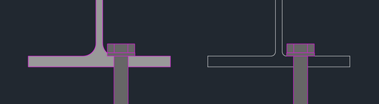

Most of the shapes are missing from the dynamic block making it rather useless (in my opinion). Besides that, it doesn't draw the I-beam web/flange radius correctly, as mentioned above, which could result in a detailing problem, like if you were to place a bolt too close to the radius, as such:
Besides that, for S sections, it doesn't draw the 2:12 inner flange slope correctly.

Having to copy and paste from a spreadsheet to edit the block for every shape that isn't included would defeat most of the benefit for me, especially considering there's no way to edit the block to make the fillet display correctly. I suppose you could explode the block and redraw the fillets, which might be a little faster than drawing it from scratch.
