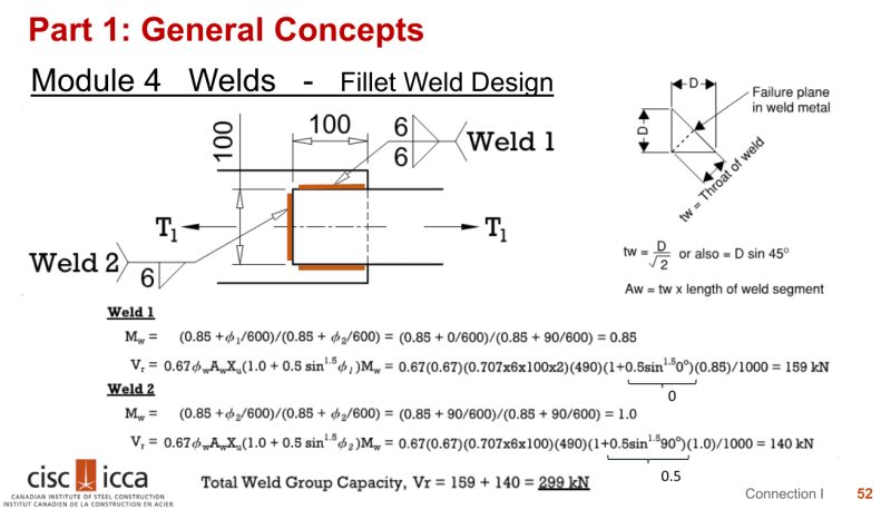

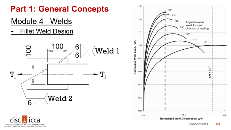

Ahhh yes, the Mw factor.
Here are some good summary slides of the concept:
You can read the research work here or pay for it here.
This doesn't really answer the question.
Given that the extreme fiber weld is normal to the force, I'm thinking my Mw will be 1.0 since theta1 and theta2 are 90°, and that is my highest stressed weld.

Sorry. The lack of question mark in your post made me think that your query was more about understanding Mw. I now see your question as:
EngDM said:
...wondering what your thoughts are on the application of Mw for all around (circular welds)...
I get what you are debating on a theoretical level, but that would require summing individual segments of the weld at various angles. For an everyday application, I would analyze at the 0 degree level and likely focus on providing a weld that develops the section.
