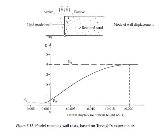

Your concern is valid for wall footings similar to fence etc. But still it is not reasonable to rely on passive thrust since the passive thrust will develop when the deformation reaches around 50 mm , literally means a wall having 2.0 m height , may have tip deflection around 200 mm .
The following figure shows the lateral displacement vs wall ht. ( from the book EARTH PRESSURE and EARTH-RETAINING STRUCTURES R.I. ClaytonRick I. WoodsAndrew J. BondJarbas Milititsky )

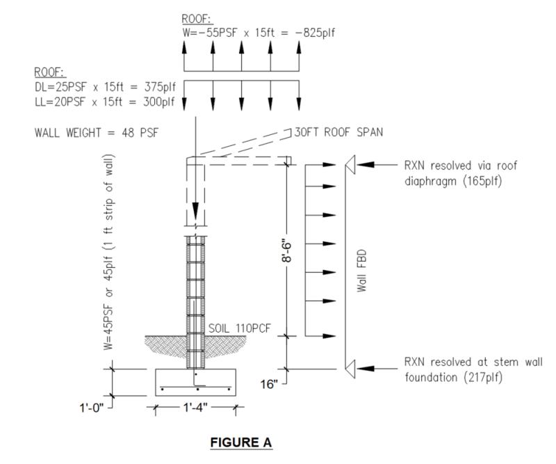

It doesn't seem worth it for a cantilevered wall. Whatever moment resistance you get will be very low for a case like you show with 16" of embedment and a corresponding small moment resisting arm. The wall has to deflect as noted above to engage the passive so now there will be some tilt at the top of the wall that will destabilize it before engaging the passive you're counting on.
It also doesn't make sense what you're doing with the fixed base if this is a full height wall supporting a roof. Should be a pinned base if there are shear walls all around.

I'm showing three figures below. Keep in mind this model is simplified for the point of this discussion. I've removed the interior slab so we can get to the point without splitting hairs.
The model considers a 30ft wide building, subject to dead, live, and wind loads. Top of wall is +8'-6" above grade and top of foundation is -1'-4" below grade. The wall footing is 16"wide x 12" thick. All the loads in Figure A have been calculated for you. Please note, this wall is continuous from roof to foundation. IT IS A SIMPLE SPAN WALL. I've shown the upper half of the wall as a hatched line because I couldn't be bothered to give y'all a textbook illustration. If you're hung-up about my use of the word "stemwall", please understand this cross-section is what we call "stem-wall" in south Florida" (2-courses below grade are solid grouted).
Considering the wind load applied to the wall, I've shown the lateral reactions at the roof diaphragm and the wall footing.

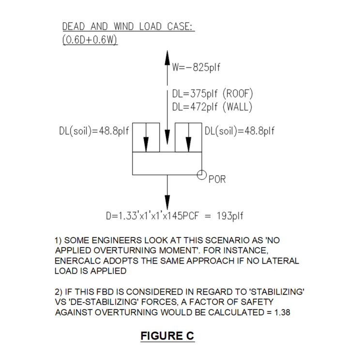

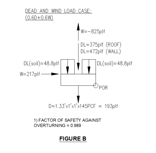

In Figure B, I've shown a FBD of the wall footing with all superimposed loads. This figure illustrates the resulting FOS against overturning, if the applied lateral load is to be resolved through the 'stabilizing' vs 'de-stabilizing' forces applied to the footing.
•The stabilizing forces consider: Roof DL, wall DL, weight of soil, weight of footing
•The destabilizing forces consider: Roof wind uplift, wall wind lateral
•The point of rotation (POR) is taken as the bottom right of the footing
In this scenario, a 16" wide footing does not pass. In the area I practice, this size footing is commonly utilized and the loads on this model are appropriate (lower half of Florida).
Now, as suggested in my OP, I was toying around with the idea that lateral loads could be resolved via passive earth pressure. To me, this is one way that my local peers are getting these sorts of scenarios to work. Let's say the lateral load is supported by passive pressure (I'm not saying this is correct, but hang in there with me for a minute), then there is no applied lateral load to the footing. There are two schools of thought here: either there is no applied OTM, or in the case of 'stabilizing' vs 'de-stabilizing', there is a FOS against overturn = 1.38.
I can't imagine worrying about something like this
Ditto for what XR250 said. Even for much taller walls and higher wind pressures I've never considered this, and nobody at any of the firms I've worked for have as far as I know. I'd consider out of plane OTM perhaps if you have a wood wall bearing on top of a tall stemwall (i.e., hinge between foundation wall and wood wall).
But, in a theoretical sense... I know you've designed the wall as pin-pin for out of plane. Realistically you have wall dowels developed into the footing. I'd wager that that joint is "rigid" enough to resolve this OTM back into the wall.
So to engage the passive pressure, up to 2" of deflection is required adjacent to the bottom of wall/footing intersection? I don't see that happening.

If you're looking at FOS against uplift only (Figure B), the sum of dead loads exceeds the wind uplift. Keep in mind, all the reactions I'm giving have calculated wind at the ultimate state. So 0.6D+0.6W is the load case.

The FOS against overturning that I gave for Figure A and Figure B, takes into full account all loads and moment arms.

StrEng007 - I would say that yes, soil pressure is your saving grace here. But not passive. I'd look at it as an at-rest condition. Passive and active pressures require movement into and out of the soil mass, respectively, to develop. At rest assumes that there is no movement. While not precisely true, it's closer than the other two assumptions, and more conservative than assuming full development of passive resistance. Full development of passive pressures is usually measured as a rotation, but I'm not sure how applicable any of the testing that derived those would be for such a small wall. I doubt you'd need a full 2 inches of movement in a 24 inch tall stem wall, but I could be wrong.
Thanks pham, that was extremely helpful. Even with walls taken up to 10 or 12 feet, I suppose these conditions would still apply.
