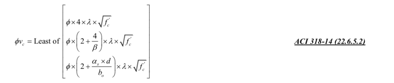

Is there any table can be used in ACI 318-11 to get Vc from f'c?
I would like to get such table to help in recognizing the depth of footing.
To get Vc from f’c I would simply use the 318 document - the formulae are not difficult. I’ve never used or needed a table.

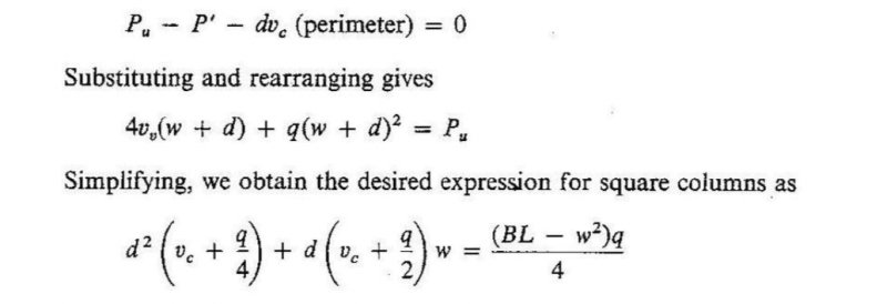

let me explain:
according to this Screenshot, we have 2 values for d, and in order to calculate these 2 values, we should have vc, otherwise we will have 3 unknowns.
Am I wrong?
But you have Vc in terms of d. You can substitute and do the algebra. Standard math type stuff.
Or, generate a spreadsheet where you guess a d, solve through and check the calculated d against the guess. Iterate until the two converge.
For oneway shear verification, it is okay.
But for two way shear penetration verification, for me it is an issue finding the minimum d
No it's still just algebra and iteration. Guess, plug, check, repeat until the guess d and the calculated d match up.
