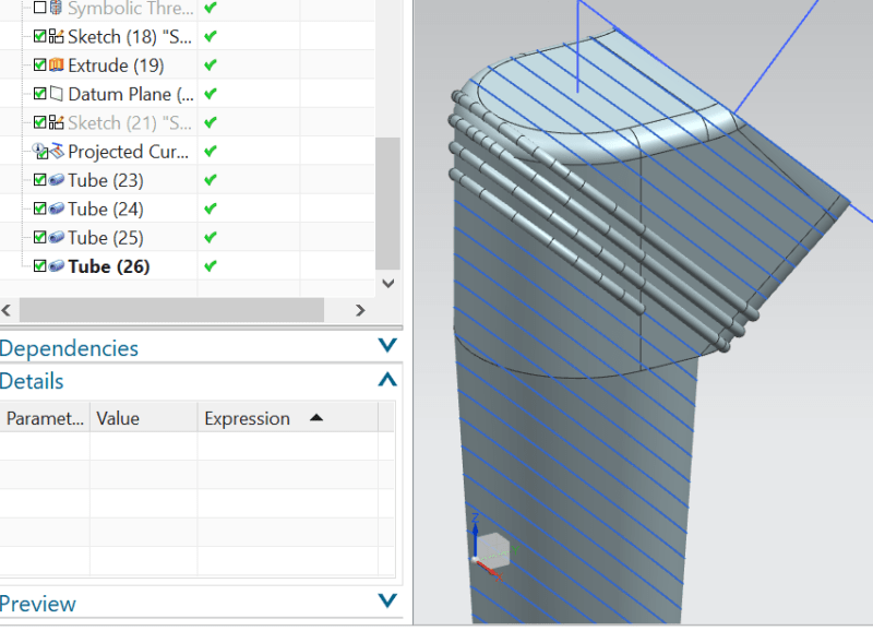

Hello there,
I am wondering if there is an alternate command to the Tube Command. What I need is: from a series of Projected Lines into an irregular shape body, create a Tube on those lines without using the actual Tube Command. I will attach an image for visual assistance.
I need an alternative route because of this problem:
The problem with the Tube Command is that it creates the feature on continuous lines, not on separate lines. So, whenever I create a Tube for each of the Projected Lines, it takes a very long time to do that. Furthermore, sometimes the complete line is not selected because of the irregular shape of the body.
Additionally, if I were to change the number of lines in the sketch---> that will change the number of lines in the Projected Curve---> But, the tube command will not follow along with the new set of lines.
It will really help me if you know some other way of generating these lines with "thickness"
I hope I made myself clear. Ask any question if you need additional information to solve this problem.
Thank you all people :)

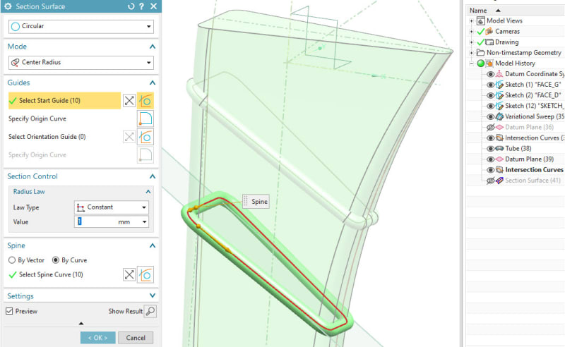

1) Check the settings in tube to create single face
2) For this design I would prefer section surface then using circular option
I hope this help
Regards
Didier Psaltopoulos

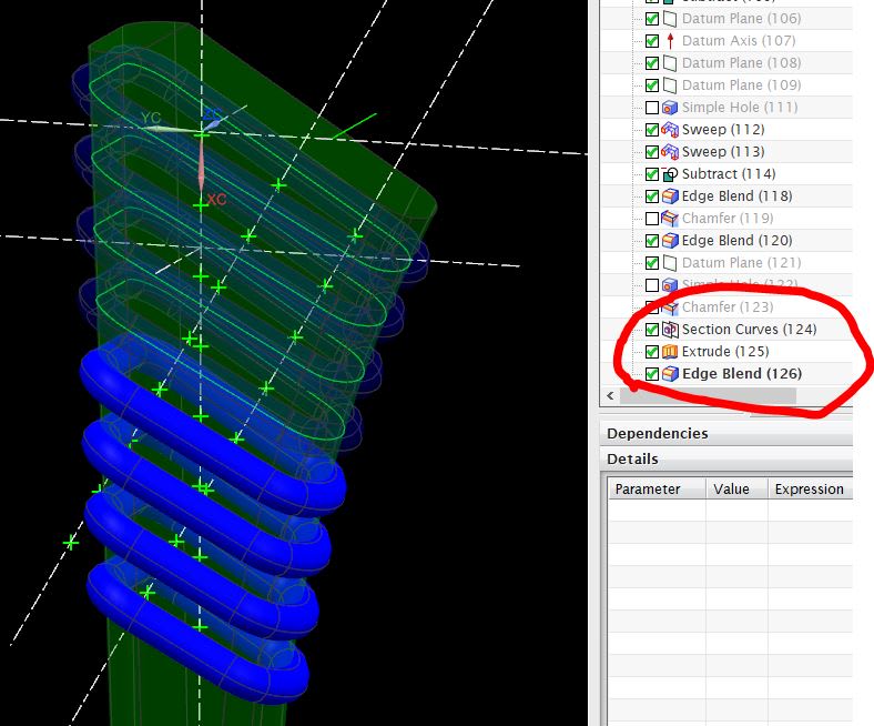

It looks as though the lines are planar (each set). If so, you can extrude the entire set symmetrically in the direction of the plane and offset symmetrically by the radius dim of the tube. Then use Blend edge and select all of the extrusion edges and blend with a radius matching the tube radius.
"Tubes" created in three features:
