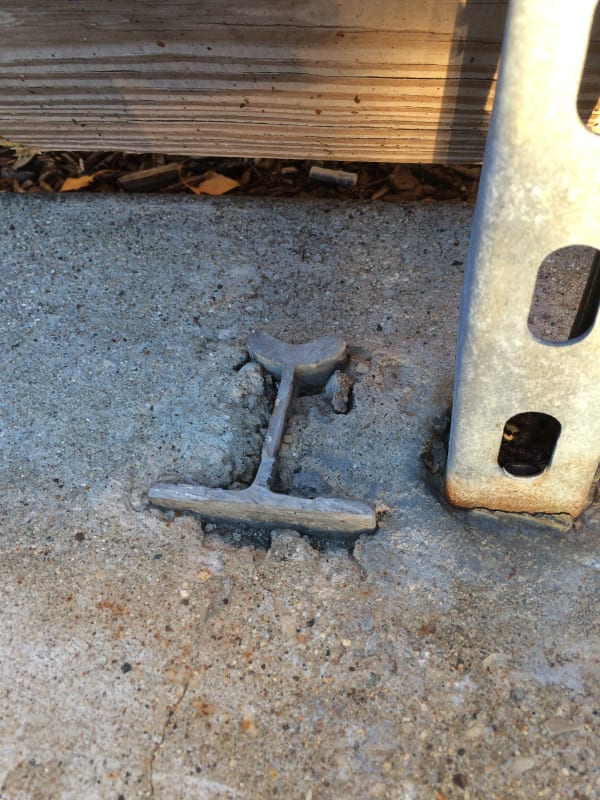

Hello Everyone!
We're looking at a job where the client would like an aluminum guardrail core drilled into a concrete curb. I've always heard that aluminum in contact with concrete is not good.. Could anyone explain to me what exactly is going on when aluminum comes into contact with concrete? Is it that you don't want aluminum in contact with the concrete during the curing process because of the chemical reaction or is it throughout the entire life of the concrete? If it is throughout the entire life of the concrete, does the grout in a core drilled hole act as enough of a barrier to where it is not a concern?
Thanks so much for all the wisdom and insight!
Aluminum in contact with only concrete isn't the end of the world. I believe more people don't like the embedded detail regardless of material for the railing. Embedding the posts may look "nice" but it really just invites corrosion to happen below the top of concrete surface that causes issues not only with the guardrail but with the concrete itself as the corrosion byproducts cause spalling and breaking of the concrete. Not to mention the potential for water freezing to expand and break stuff as well depending on the local climate.
If you live someplace where it snows, and there is salt used, then corrosion is assured.
There not really a good long term way to prevent water down in the hole.
The wide flange has been cut, the smoother potion is fracture face.
