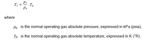

In API 520 ( sizing of RVs'), there is a procedure for gas phase (blocked in) thermal expansion due to fire. In this procedure, Tw is usually taken to be 1100degF during fire. in your case, set Tw to be the max hot side temp to get the required RV orifice size. And the exposed surface area would be the total tube side surface area.
@ georgeverghese (Chemical), in this procedure when i set Tw to be max. hot side temperature, its value came lesser than T1 (the relieving temperature), this way the equation can not be used (it will result in negative base for the exponent 1.25). The equation is in API 521
T1 is the relieving temperature, calculated by the equation
P1 is the relieving pressure.
I think this means the hot side temperature is not high enough to cause the cold side vapor to expand to the degree which can result in over pressure scenario, in this time the differences between cold side operating temperature Tn (the temperature at the time of the blocked in) and the hot side max. temperature is small.

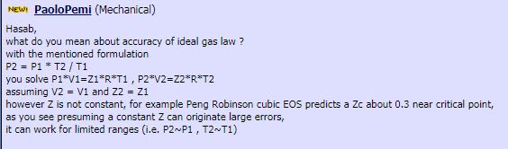

Hasab,
what do you mean about accuracy of ideal gas law ?
with the mentioned formulation
P2 = P1 * T2 / T1
you solve P1*V1=Z1*R*T1 , P2*V2=Z2*R*T2
assuming V2 = V1 and Z2 = Z1
however Z is not constant, for example Peng Robinson cubic EOS predicts a Zc about 0.3 near critical point,
as you see presuming a constant Z can originate large errors,
it can work for limited ranges (i.e. P2~P1 , T2~T1)
@paolopemi, once you add the "Z" its not the Ideal gas law (obviously). So if you dont have a tool to determine Z its not much help.
the formulation P2 = P1 * T2 / T1 includes the contribute of Z but as constant value Z(P1,T1),
consider the case of C1 at 210 K 50 Bar.a , Z = 0.659 (GERG 2008) , V = 0.0143... m3/Kg
if you solve a V-T flash operation with V = 0.0143... m3/Kg , T = 220 K the result is 54.99..Bar.a
at 220K, 54.99 Bar.a Z = 0.692
now if you solve with the simplified correlation
P2 = 50 * 220 / 210 you get 52.4... Bar.a
however if you add the correction for Z2 / Z1 due to the fact that Z is not constant over this range
P2 = (0.692/0.659) * 50 * 220 / 210 ~ 55 Bar
which confirms what said in my previous post
