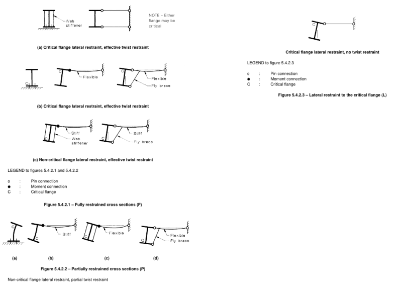

While the inflection point is not a point of restraint, often the next purlin or roof joist past the inflection point where the top flange is in compression can qualify as a brace/restraint if connected to the top flange in a manner that prevents twist of the cross section or prevents lateral movement of the top flange (or both).
Hell if the cross member is stiff enough it can also brace the bottom flange in compression to some degree, see the following diagrams from NZS3404 for some guidance for example (critical flange is the compression flange):-
If going down the prevents movement path for lateral restraint to the top flange then something beyond the member needs to support the restraint of the movement (existing roof bracing, connection to something solid like a concrete wall, etc).
