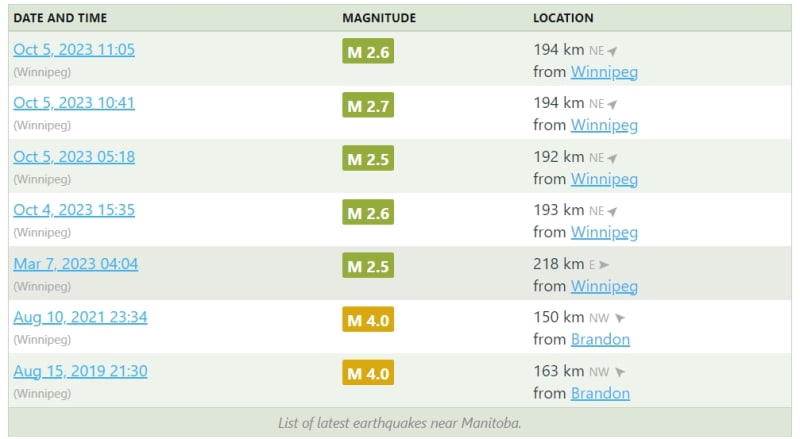

This is just so much government overreach horsesh*t. My understanding was that when Manitoba Hydro was researching their Nelson River Diversion project there were two below R2, and they were archaic. A current website shows:

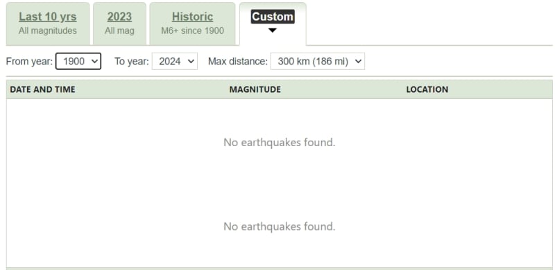

and none of these were in Manitoba. In addition another shot of their site shows:
The government is just increasing costs to owners and businesses for no reason. I understand they were citicised for not including seismic provisions in the last code they adapted. For good reason, we are relatively safe from seismic activity in Manitoba. The professional association should be taking them to task on this.
