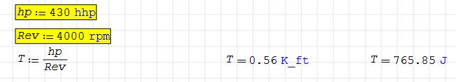

Typically designing for the force generated by the pump in a lock up situation is how I will design the anchorage with no additional information. Max Torque formula at lock up taken as T= HP*5252/RMP, where HP=horsepower and RMP is the motor speed. The torque is then resisted by the couple between anchors.

in SMath:
