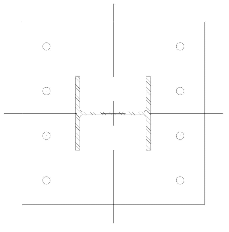

Hello,
I have a heavily loaded column with 8 anchor bolts. The foundation and anchor design was done by others (prior to me on the project) and is already IFC. I am tasked with finalizing the steel structure only. So regarding why the anchors were laid out a certain way - I am not able to comment nor do I agree how they were done - just need to try and work with it.
The issue I have is for the baseplate design, we have gussets for vertical bracing that will restrict access to the anchors. I am having trouble picturing how the interior 4 anchors will be tightened, since the exterior 4 are "in the way". Only snug tight is required, the anchors are 1-3/4" diameter.
Can someone please comment on experience as to how these nuts can be tightened?

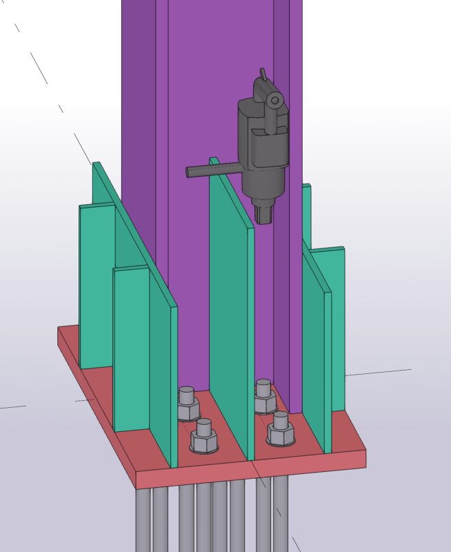

With a wrench and an extension bar? I don't see an issue here as long as it sketched to scale. The bracing won't be there until the anchors are installed.
1-3/4" socket with a couple of long extensions and a breakover or ratchet, is the only way I can think of to get to them.
Here is an image of the geometry. Seems like a solvable problem, but you will have to figure out what tools fit. The brace bolting seems it could be challenging as well.
Found model of impact gun for up to 42mm bolt. Might work, but 1.75" = 45mm. Did not find a model of the extension.

Something like... [pipe]
Dik, its his job to figure it out. I asked Dr. Z a question like this before, and he posted a CAD view of the connection with the tool included in the dwg.

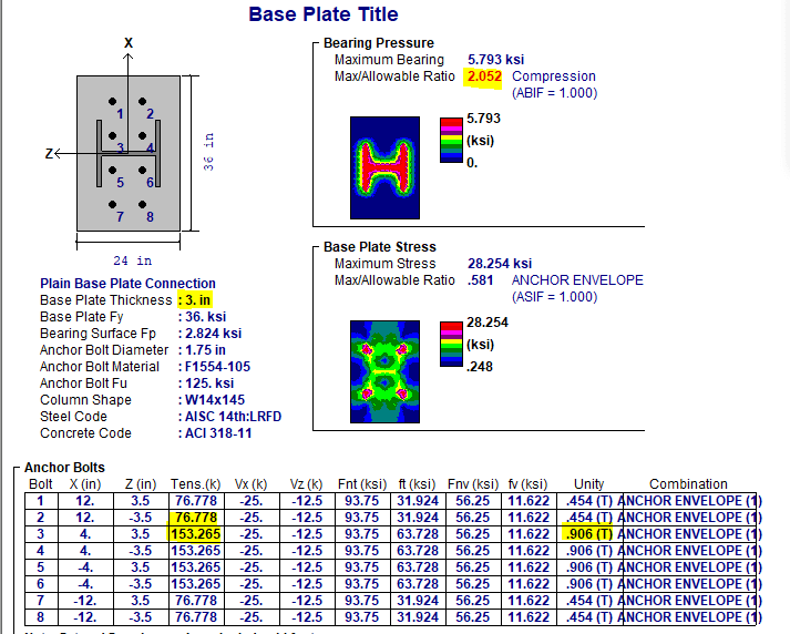

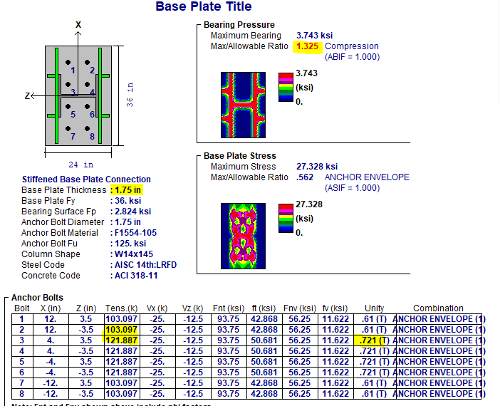

Regarding the question of the stiffeners - These are provided to ensure equal distribution of the tension load to the further anchor bolts (anchor capacity for tension breakout is 125k) and to reduce the local bearing pressure on the base:
I will definitely look at reducing the length of the stiffeners required to allow more access. Regardless of the stiffeners, the confinement is mostly provided by the central brace gusset. With what you have said, I feel it is feasible to tighten the anchor bolts.

You bet! Again - I just got handed this and first thing I saw is "how are you going to access those bolts... ". I spent an hour on a quick analysis to get a feasible baseplate that met the anchorage design. Now that I agree we can tighten, I can burn a couple more hours sharpening the design.
Super tight budget on hours these days... thanks for the valuable input!
...not hours, minutes... easy thing to check and difficult to analyse...
Canucks1010 - can I ask what software that is you have checked the baseplate with?
I come from a different time... I'd simply have used my Excel or SMath program... just a couple of minutes and it's done...
