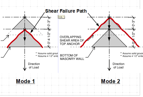

For a double row of anchors in a masonry wall I am trying to figure out for which failure modes it makes sense to split up the load into the two bolts to effectively double the capacity of my connection. For masonry shear breakout and masonry crushing I think it makes sense to apply the entire load to the bottom anchor because the top anchor will not have any capacity once the failure modes are reached. For shear pryout and steel shear I think it makes sense to divide the load into the 2 anchors because there is no overlapping area of influence therefore you will get the full capacity of each anchor independently. What are your thoughts on this?
 https://files.engineering.com/getfile.aspx?folder=418833b2-2221-4cfb-924e-1ead60b57328&file=masonry_anchors.PNG
I found info regarding shear breakout in ACI 318-14 Figure 17.5.2.1b. I think these ideas can also apply to masonry and specifically the masonry crushing failure mode.

The bolts receive the load due to the tendency of downward displacement of the base plate. If the upper bolt, or the plate, is strong enough to resist the load without measurable displacement, the lower bolt might not feel much of the load. However, metal yields, thus the lower bolt eventually will share the load. The ratio of the load sharing will change and is usually assumed 50/50. Note that, on top of shear, the upper anchor bolt is likely to carry tension, which will render it more critical, so you have to ensure this failure mode won't occur.

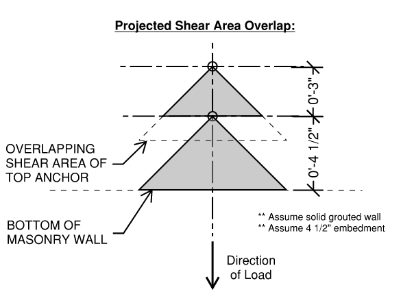

masonrygeek - I was using TMS 402 to design the anchors but I think I came across a condition that TMS does not provide guidance for. I have posed this question to the committee and they admitted that they have not thought about this particular condition. See my attached sketch. The question becomes what do you use for your shear area. ACI thinks (if this was concrete instead of masonry) that it would be acceptable to use the edge distance to the top anchor in determining your shear breakout area, assuming the anchors are welded to the plate (they also provide guidance for when anchors are not welded to plate). I think this would be an acceptable procedure because for shear breakout to occur, both anchors would have to breakout. With a similar anchor layout, do you think it would be acceptable to divide the total load to the connection between the two anchors for the masonry crushing failure mode per TMS?
I would check both modes depicted below.
