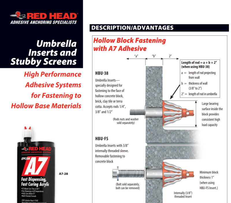

I would like to anchor a steel plate to face of hollow clay tile unit with toggle bolts, collapsible screw sockets, self-clinching nails, epoxy screens, umbrella inserts, etc. as shown in the following images. One important check is face shell flexural tensile stress. Does anyone have a method of estimating the modulus of rupture? TMS 402-13 table 8.2.4.2 lists the wall assembly at around 20 psi, but these values are typically controlled by the interface between mortar and unit, so I would expect unit capacities to be higher than assembly capacities. ASTM C67 "Standard Test Methods for Sampling and Testing Brick and Structural Clay Tile" does specify test methods for modulus of rupture, but I have an ASTM C67 test report from National Brick Research Center on Elgin Butler clay tile, and only compressive strength is listed in the report.

Mason geek, Helifix Cementie is also a pretty bad ass product. I'm happy to know about these products even if they don't lead to me quantifying masonry units. You must be in Europe? I hear clay tile is more common in England. Here's a cool umbrella product in US:
