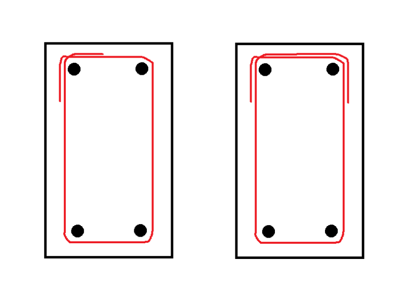

Just wondering how everyone feels about the two alternative shear reinforcement arrangements below:
The reason for not using the typical 135 degree hooks in this situation is to avoid clashing between the hooks and some spiral reinforcement behind a PT anchorage (not shown). Ideally the shear reinforcement would not intrude into the core of the beam.
Obviously the option on the left is generally not acceptable. In Australia the rule is: "Fitment cogs shall not be used when the anchorage is solely in the outer layer of reinforcement. In this case fitment hooks shall be used." I believe the rule is generally the same across the various codes.

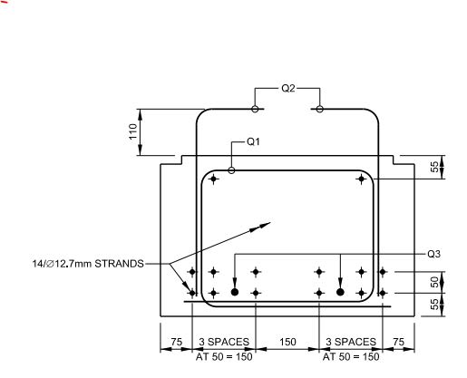

Any thoughts on the arrangement on the right? I believe there must be a point at which the cogged part of the stirrup is long enough to avoid the stirrup losing anchorage when the cover is lost. For example, see below the standard prestressed bridge plank used by the state road authority in NSW, Australia. This strictly does not comply with the rule mentioned above ("Fitment cogs shall not be used when the anchorage is solely in the outer layer of reinforcement").
Then the one on the right is unacceptable for the same reason. Use double stirrups and let the cogs on opposite ends.
I disagree with r13. The arrangement on the right would satisfy my interpretation of the code.
Yeah, I would agree.
Neither would be allowed round these parts (NZ).

So when you can't bend the legs 135°, what is your option in NZ?
If you are designing according to the Eurocode read the note below. However, if the beam is subjected to torsion the second detail you showed should be used, and if seismic is in play then the link should be properly tied around the beam steel, both open links you sketched are not permitted/recommended.
There is no alternative from a 135/180 hook apart from welded anxhorages. There is only one scenario where a 90 degree hook is accepted by our code, but no one uses it in practice because it is an inferior detail to have 90 degree hooks in the cover concrete in the seismic detailing realm. I shudder when I see this is still acceptable in other major international codes with no limitations on use. Guess it depends on what your 'normal' is.
This one time scenario is in beams where a slab is present and this slab stops the return hook from unravelling. Otherwise stirrups/ties/spirals require minimum of 135 dehree hooks in all members (walls/beams/columns/slabs) for every single stirrups.
It never seems to be an issue in practice, there is always a way. Flip the stirrups to locate hooks in alternative location, use a U shaped bucket stirrup with closing link, lap stirrups, weld stirrups, use smaller diameter stirrups that can be more easily be bent on sire, etc, etc, etc.
