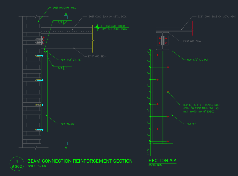

I'm in the process of designing a wall mount to an old unreinforced hollow masonry wall. It was built in the early 60's, so I'm not surprised about the wall construction.
Anyways, my calculations are showing it needs to be grouted solid to support the needed loads. We also don't have have enough space on the inside of the wall to do a through bolt and a backing channel, so I'm trying to figure out what anchorage would be the best solution. I usually like adhesive anchors, but it seems odd to use that in wet grout. I also think a mechanical anchor probably doesn't really work in fresh grout either. I'm leaning towards a cast-in anchor, but I would prefer to not put a huge hole in the wall. Thoughts everyone?

Thanks for the suggestions. The screen tubes don't really provide the capacity that is really needed. Even if it did, I'm struggling to get the global wall to check out (especially since it probably never checked out to current code in the first place). My issue is the penthouse has virtually no compression in it, so it doesn't take much to exceed the allowable flexure capacity of unreinforced masonry.
My client wants to hang about 500-800lbs of dead load and maybe 500lbs wind load (ASD) off two brackets that are about 4 feet to maybe 6 feet apart. The loading may have a little cantilever in it but I'll try to talk them out of it. Adding a WT or channel is actually not a bad idea. Essentially arguing the wall doesn't need to carry the flexure load and it only needs to carry the shear (which probably will check out. It's just a matter of getting the wall to act compositely. I completely agree Milkshakelake that it would be very difficult to cast the anchors in and not have the grout come out of the holes.
I have started using a mechanical Powers product for older two-wythe brick structures as their load tables are rated for that and Hilti's are not. I also prefer adhesive anchors to mechanical ones for older structures.
I think regardless of which connection you use, the wall will need to be checked for axial+flexure because of the eccentricity of the load. There's no way to remove the eccentricity completely unless you make a pocket in the CMU. The WT might reduce tension in the anchor bolts and spread the shear to more anchors, but doesn't help with the global flexure.
True true. I was thinking of just saying the CMU wall didn't need to carry any of the flexure if the WT or channel (which is probably the shape I would lean towards) could carry the flexure alone. I do have a concrete pan and joist penthouse and main roof, so I feel as long as I can get the shear load from the flexure into these diaphragms, I should be OK. My hunch says these CMU unreinforced walls should have the shear capacity at the top and bottom to carry the load I need it to. But yea, it's not technically correct because there is still an eccentricity the channel would be putting on the wall that I'm not really accounting for.
