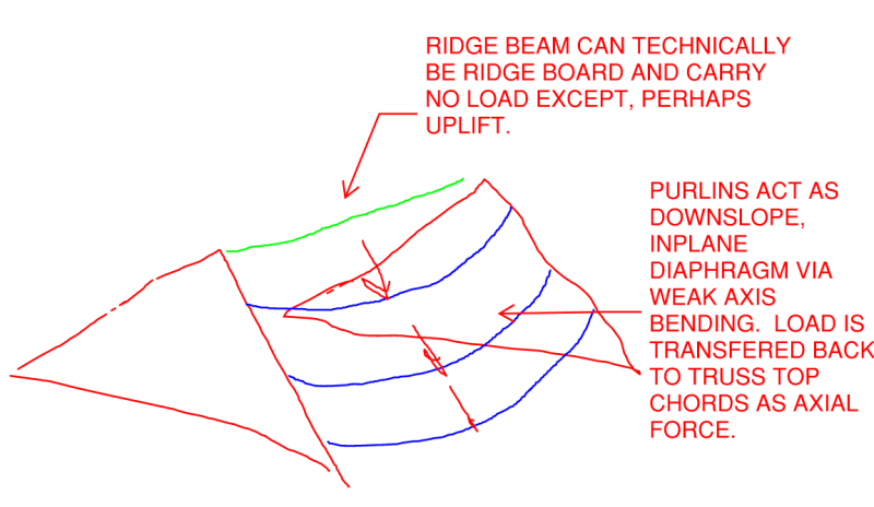

Meh. I might claim that load path in the context of a desperation play on an existing structure but I wouldn't normally consider that path to be desirable in the context of a new build without some very careful detailing to go along with it. Moreover, I don't think that you need to use the top plate that way. There's a much better story to be told about how the ridge beam is shielded from load. If I understand your situation correctly, the load path shown below will be much stiffer and stronger anyhow. And it ought not require unconventional detailing.

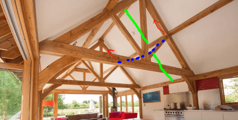

This would be a typical example (credit to Oak masters - not the company I was talking about tin the first post)
Yes I see what yo are saying. And the purlins are very often square sections laid in the plane of the roof pitch, so very effective at transferring thrusts back to the trusses.
In some cases on very short spans there are no purlins, in which case the wall/top plate may come back into play. But the forces are lower overall anyway. The detailing I'm not so worried about unless there was a splice involved.
Are you able to rely on the roof sheathing itself to provide the downslope diaphragm action? I know that this strategy is less popular outside North America.

Still, even if your "sheathing" is just decking boards, I'd be willing to bet they constitute the stiffest load path available in the plane of the roof.

Just to add to this, I was looking at my old barn with this type of roof.
I hadn't noticed before but there is a tie at midspan between the two purlins (behind the king post truss), this is presumably to prevent spread of the purlins with that lateral thrust.
This is onto a small wall plate sat on a masonry solid wall.
Note the ridge board (certainly not a ridge beam), so all thrust must being carried by the tied purlins.

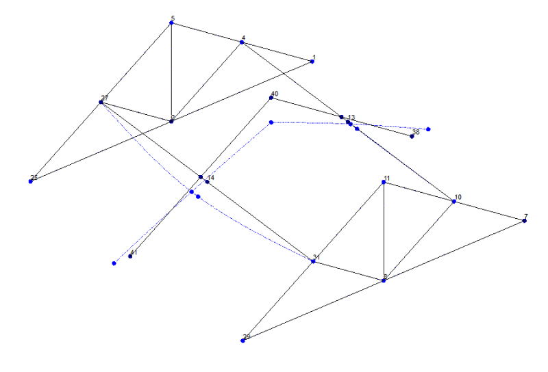

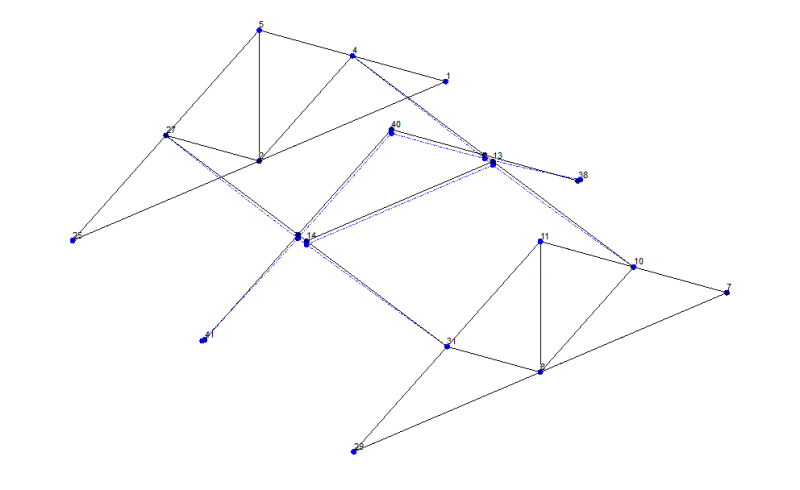

Edit - right, built a quick model. Very rough and ready:
ith the exact same loading (1kN at the ridge), roller supports on the rafters and highly exaggerated deflections and axial force (but the same for each model).

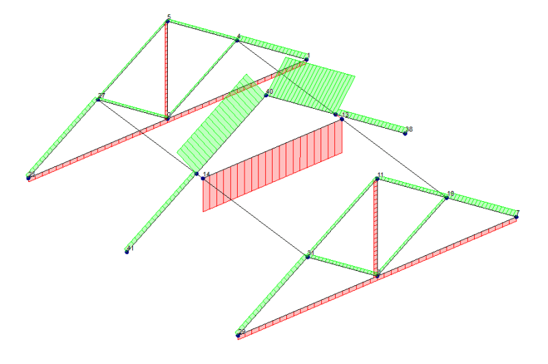

With the tie
Gets a tension force developed in the tie, as expected:

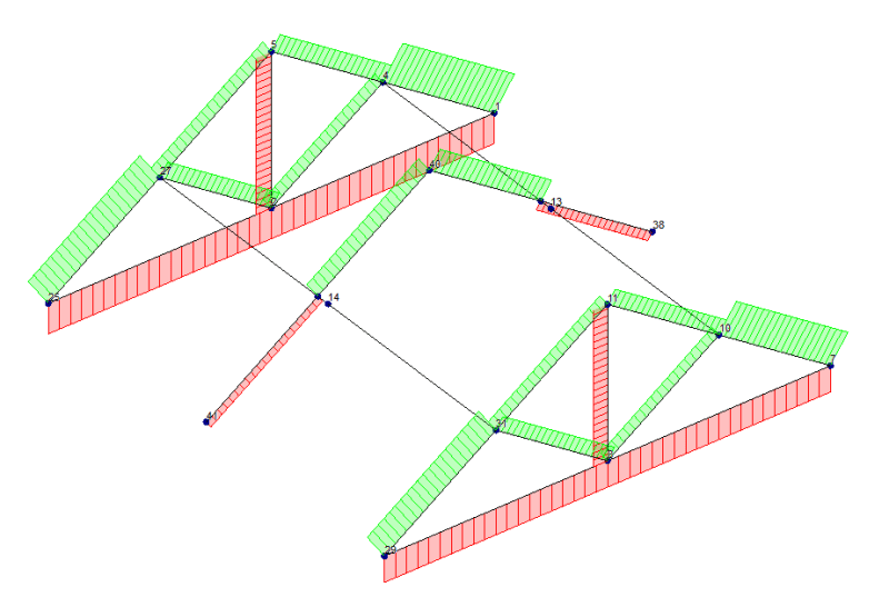

Without the tie:
