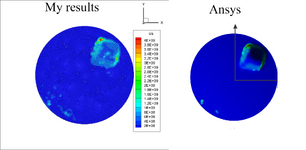

When I attempted to plot the stresses found in the .txt file, I obtained results that did not make sense. See the attachment, please.

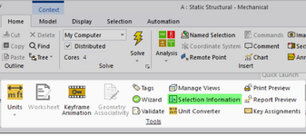

Step 1: I select the "Selection Information option in the Tools group on the Home tab to obtain the coordinates of a node with ID 3015.
Step 2: As I mentioned earlier, to export the data of a contour result, right-click the desired result object, select Export, and specify a file name and file type.
So, I got the following.
(ID 3015) 3.16E-02 (x) 5.83E-03 (y) 7.88E-02 (z) 5.10E+07 (stress)

As I said before, when I attempted to plot the stresses found in the .txt file, I obtained results that did not make sense. I'm looking forward to hearing from you and appreciate your help.

are you plotting on a deformed model ? the black part of the ANSYS plot looks 'odd"
are there reasons for the stress variations ? (like maybe applied loads)
What is the black part that appears out of place?
Yes, the reason is that I used an intruder *gambling die* to measure granular surface tension.
