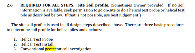

Some helical manuf recommend an alternative soil investigation, see pg 24 (2-5)
HELI-PILE® SIMPLIFIED DESIGN AND INSPECTION GUIDE

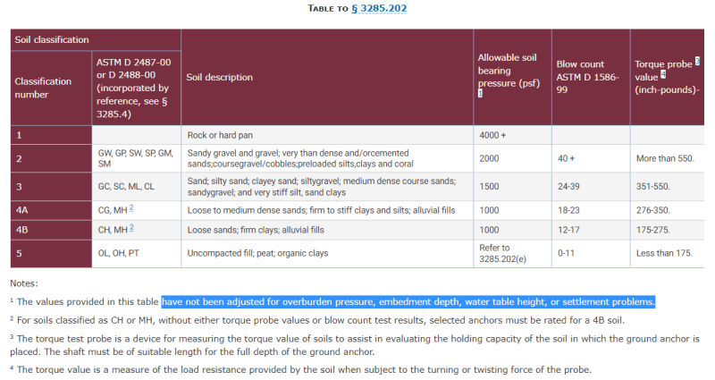

Load test can exceed a geotech report, could it replace?
2022-09-28_18_07_01-Chapter_18__Soils_and_Foundations_Building_Code_of_the_Department_of_Personnel_f5jyzt.png

Just to clarify my understanding a bit... There have been a few statements suggesting that prescriptive soil values (e.g. IBC) do not account for settlement. Is that entirely true?
I understand concerns about particularly sensitive structures, or about regions that geologically are likely to have varied stratigraphy. But I was under the impression (and practice) that prescriptive values do include some consideration for settlement -- appropriate for a structure with a continuous shallow footing and known soils within the influence depth.
When comparing a calculated strength capacity against the prescriptive value, there's often a huge variation. Are they accounting for some factor other than settlement?
just call me Lo.
Lo,
I believe the table in the IBC does account for settlement. But the question is, what soil type is it? I'm sure there's lots of pressure (especially in residential construction) to assume a more competent soil so that the foundation size is reduced.
My company will use the values in the table frequently - but we ALWAYS assume that the soil is the worst, which puts the GBP at 1500psf**. We tell our client right away - if you don't get a geotech report, we're going to assume the worst soil type and won't budge from that. If they want something better, then they need to get a geotech report done. Granted, I don't do residential, so who knows what pipe dreams the architects and contractors are telling the client about foundation sizes.
**A quick digression - assuming the worst soil profile doesn't always guarantee a conservative design. I had a site in Kentucky that had a geotech report done, and the allowable GBP was reported as 1200psf!

Regarding the Heli-pile Simplified Design And Inspection Guide
2022-09-28_17_17_10-DesGdMarch2020.pdf_and_9_more_pages_-_Personal_-_Microsoft_Edge_bzijxm.png
they're suggesting a test probe, I'm guessing that's a lot cheaper and can tell you more of what's below bearing depth but I don't know exactly what it is, and if it is enough to keep us out of trouble. It sure wouldn't give a recommendation for settlement. Has anyone gone with something like that and regretted it? Is an ADU low enough risk to manage without geotech recommendation?
