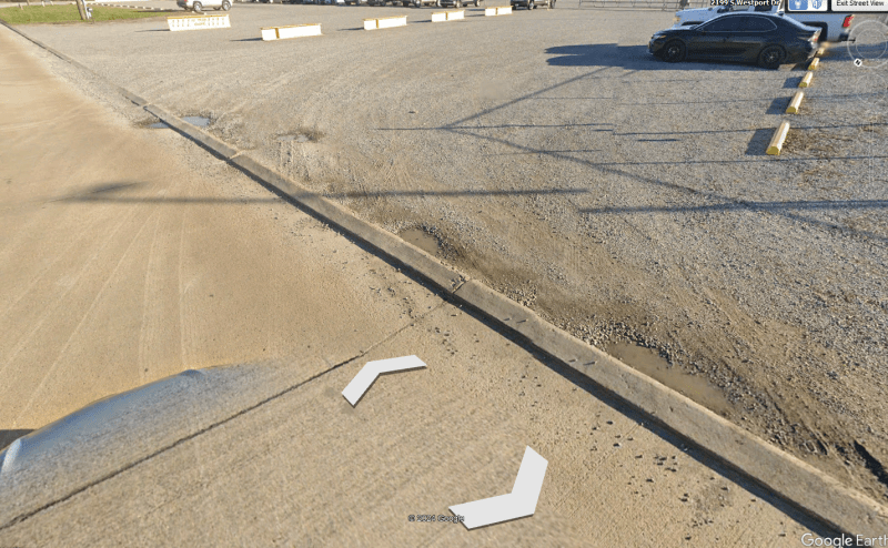

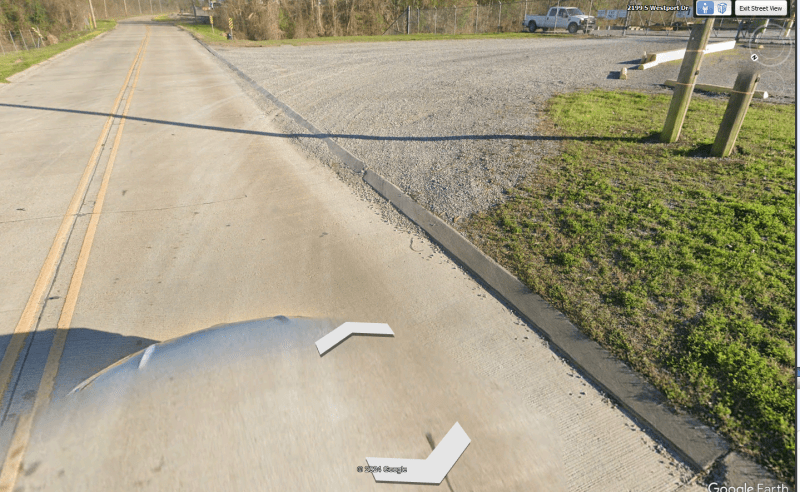

For fun, here's Google street view of the subject entrances.
Apparently, these have existed this way for a number of years, and for some reason this is a new issue. I think the original site plan had them including the Aprons, and they never did.
But you can clearly see the potholing adjacent to the curbs, and some of the curbs are cracked up in some spots.
