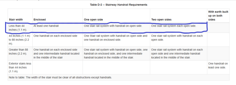

Here is OSHA table D-2 FYI. I don't see in any case handrail is not required.

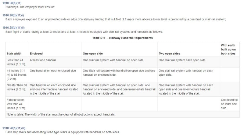

retired13, you circled the case where a handrail is not required. The confusion may be over the use of the term, "stair rail system". As I have circled below in red, a stair that is open on both sides and less than 44" wide is required to have a stair rail system on each side. This stair rail system is the guardrail, it does not include a hand rail in its definition, which is: "Stair rail or stair rail system means a barrier erected along the exposed or open side of stairways to prevent employees from falling to a lower level."
To confirm that OSHA does not intend this to (have to) include a hand rail, directly below the entry in question you can see that they do specifically require a handrail along with the stair rail system if the stair is 44" or more in width (I have highlighted the text I am referring to).

retired13, I don't see any handrail required for a stair less than 44" wide that is open on both sides. For that, it says "stair rail system" is required, not "stair rail system with handrail", as required for one open side. It may be an oversight or an error, but they've been aware of it for quite a while and it hasn't changed.
retired13, I didn't see in the document you linked to where it says under what circumstances a handrail is required, just what qualifies and what doesn't. The closest it comes is the illustration for "after January 17, 2017", but it does not show a width for the stair.
