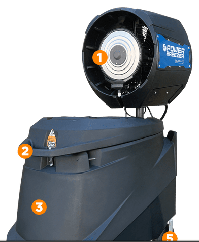

There is a relative of the swamp cooler that is somewhat useful OUTDOORS in moderately humid environments.
These also work OK taking the edge off of a hot shop, as long as they are set in the doorway, and do not recirculate any shop air.
