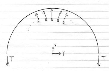

Let's go back to basics and make a simple free body sketch of the tension ring split across the tank diameter.
Based on the plate span limits of 5.10.4.4 I'll guess you have 50 rafters, and thus there will be 25 radial rafter loads in the free body. I will leave the exercise to you to sum the X component of each load, and then half the result to arrive at the tension in the roof-to-shell junction. However if you get anything different from the 5.10.5.2 result you need to look at your math again.
The tension force in the ring is not the local effect of a single rafter load, but is a global effect of many loads. Thus it must be continuous and uniform even though you are using rafters.
You can do FEA, but it is overkill when a simple free body will answer your question.
