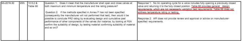

So as your explanation above, that Annex F is not a "must" requirement to validate our design except manufacturer or purchaser specified it, in other means this is optional. And as you said that the only normative talks about validation in 6A is only in section 14, which is about cyclic test and this test up to us to make the procedure but still makes sense accordance with PR1 requirement in section 14. but in Query number 30 of API 20th edition,
Sentence with red underline, that cyclic test is design requirement which not necessarily validation test requirement, i kinda confused with this sentence, it means that cyclic is not a validation test that may validate our design ? so what test then we must use to be our validation test ?
Hopefully you may answer this, many thanks in advance sir
The interpretation matches what I said: the only normative validation requirement in 6A is in 5.5 that "Manufacturers shall document their design validation procedures and the results of design validation." The PR requirements for a number of cycles is a "design requirement" but not a validation test requirement.
It means that testing is not necessarily required to meet this requirement. You could rely on other evidence (documented field history, simulations, or whatever you can convince an auditor is reasonable) to show that your equipment can perform the required number of cycles. It does not prevent you from testing the specified number of cycles to validate that your design met this requirement. You determine what testing you need to validate your design.
