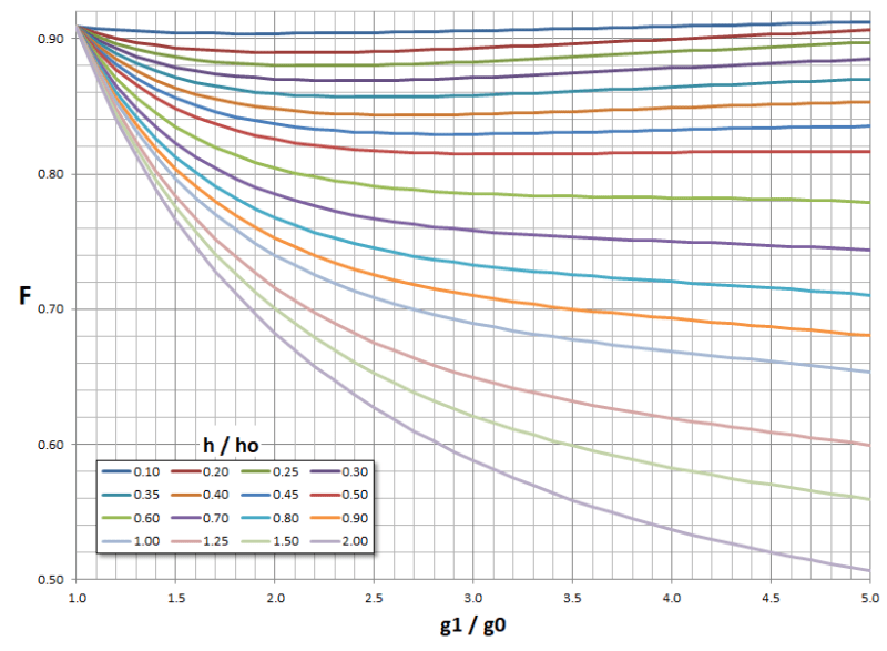

I'm trying to do appendix 2 integral flange calculations in excel and I want the long formulas found in Table 2-7.1. I've got them all there and checked, double checked, checked by 2 other people... but I can't seem to get F,V and f correct when g0 & g1 are not the same.
I did stumble on a post from years ago that someone did mention they recalled something off about the equations, but i figured I'd start a new thread since that thread was over 5 years ago and no real solution was posted.
I've had my own Appendix 2 flange spreadsheet for years. Just did a quick modification to it to create my equivalent to the Figure 2-7.2 graph for F (without the log-log axis scaling). The V and f graphs look equally close. Seems to work for me, so I'd guess the Table 2-7.1 equations are OK.

My spreadsheet is obviously very similar to yours, so I used your inputs, and then looked for differing outputs. A couple of items outside the Table 2-7.1 formulas caught my eye as well.
[ul]
[li]Formula for He (cell M67). Should also use 0.785, though I prefer PI()/4 so I can understand what the formula is doing.[/li]
[li]Formula for C7 (cell M115). The brackets aren't correct. Should give 12.8989[/li]
[li]The additional levels of brackets in all the formulas make them impossible to review. The formula for C7 needs only one set of brackets, and then it's obvious if they're correctly located. I changed your C7 formula to: =215/2772+51*$O$103/1232+(60/7+225*$O$103/14+75*$O$103^2/7+5*$O$103^3/2)/$O$104 to check it got the right answer.[/li]
[li]Formula for C14 (cell M129). Should be /35, not *35. Should give -0.1825[/li]
[li]Formula for F (cell M180). The final term should perhaps be *(-1) to get the negative of the entire equation? I would just add a - at the formula beginning. Should give 0.8234[/li]
[li]The formulas for F, V and f are within IF statements. These simple values noted in Table 2-7.1 are to save someone doing the C1 thru C37 calcs in these special cases, but the spreadsheet is always going to do the detailed calc, so just keep the formula and delete the enclosing IF.[/li]
[li]I can't find where you are including Bsc (Appendix 2 Equation 7). This should increase all the Mo values by 1.3208.[/li]
