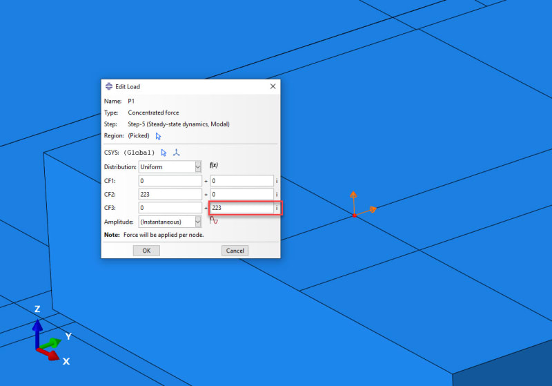

I create tie constraint between the top surface of a solid elements structure, and reference point to which we apply a concentrated load. I want this concentrated load to be spread out over the surface:
When I run the job I get the error: "Too many attempts made for this increment Job XXX: Abaqus/Standard aborted due to errors." Any ideas what might be causing this?
Don’t use tie constraint for this purpose, it’s not meant for such cases. Use rigid body or kinematic coupling constraint instead.

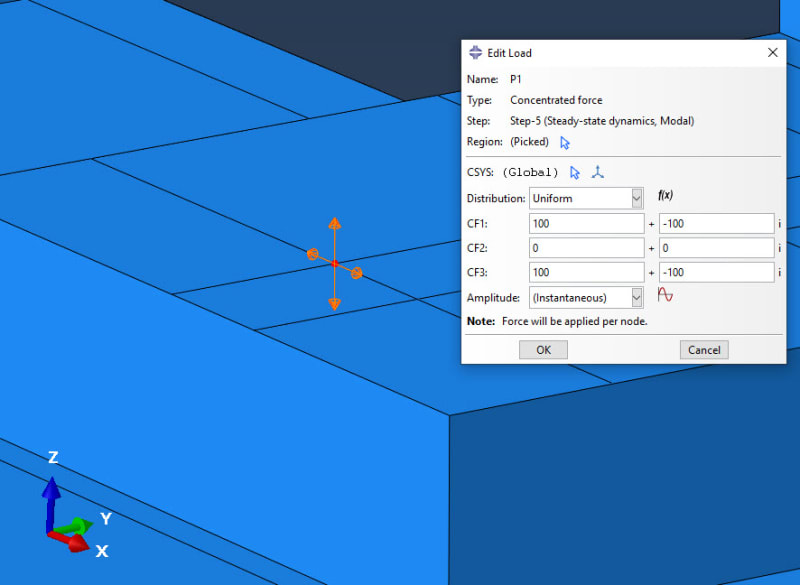

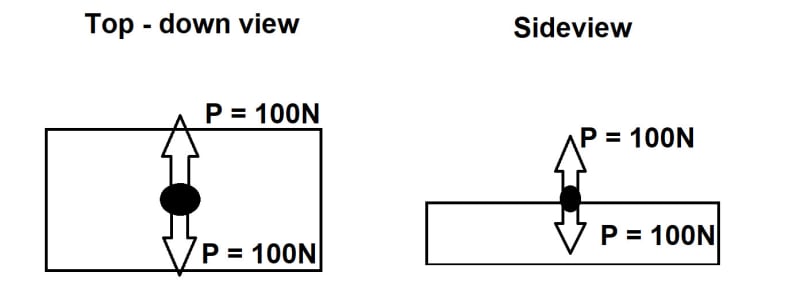

I know I said last question, but I just have to ask one more because I get so much out of it; If this is how the loads Ive been given look like, 100 N (from a rotating mass) acting on an object in four different directions , how would you apply them in Abaqus?
Would this be correct? I am assuming the imaginary component of the load will have as much of an impact on the response as the real component. And since the imaginary part of the load acts in the opposite direction of the real, it will also be out-of-phase, hence making it correct to write it in the right box with the "i" after?
I still wouldn’t use the imaginary loads unless absolutely necessary and just define real ones in each direction. But it all depends on the details of the problem that you want to simulate. If this is some kind of standardized test, you may find guidelines in engineering codes. If it’s a typical loading experienced by a particular type of structure, literature might be helpful.
Not only the direction of loads is important but also how they vary in time with respect to each other.
