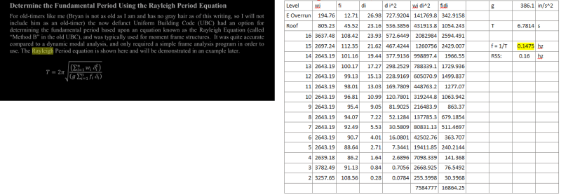

Not sure if you're interested or not. But, when I was working for RISA, I put together a few "example" or "verification" problems to demonstrate the accuracy of the programs Eigen Solution (and an estimate of it's flaws since it didn't account for P-Delta softening).
I've attached the write-up to this post. If it would be useful to you, I can probably track down the Excel file and RISA files that were the basis of this write-up. Just let me know.
 https://files.engineering.com/getfile.aspx?folder=aecf69b8-c0b8-47e1-845e-3b87e2662d6a&file=Rayleigh_Method_of_Period_Calculation.pdf

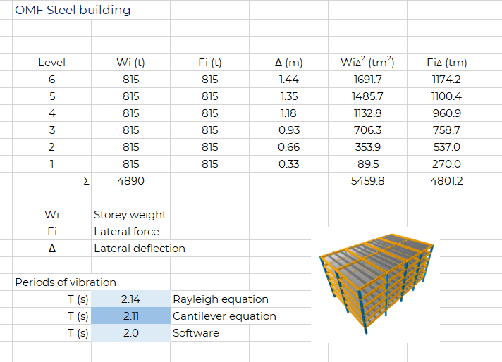

I've run some numbers using a steel moment frame building I was working on. Six storeys (4m typical heigth), regular building, 10 m bays. See attached picture.
First, I consider Rayleigh method as suggested by KootK and JoshPlumSE. This method has the advantage that is not very sensitive to the lateral load pattern. In this case, I used a uniform load, equal to the storey weigth for seismic design, so we can compare the method suggested by FE_struct1 wich only requires top deflection. As you can see, for this regular example both methods are close to the result reported by the software.
WillisV Great article that clarifies the purpose of the code formulas. By the way, I've checked at New Zealand Standards and they used an approximated period for SLS and another for ULS. In contrast ASCE periods are calibrated from buildings subjected to ground motions that apperar to be at service level.
Wow. I'd say that's an astonishing level of agreement really.
I was also surprised. May be the ideal building, I will try to check other building models, some of them taller and with irregularities.

as another reference point here is a comparison with RAM for a 16 story PT concrete structure:
