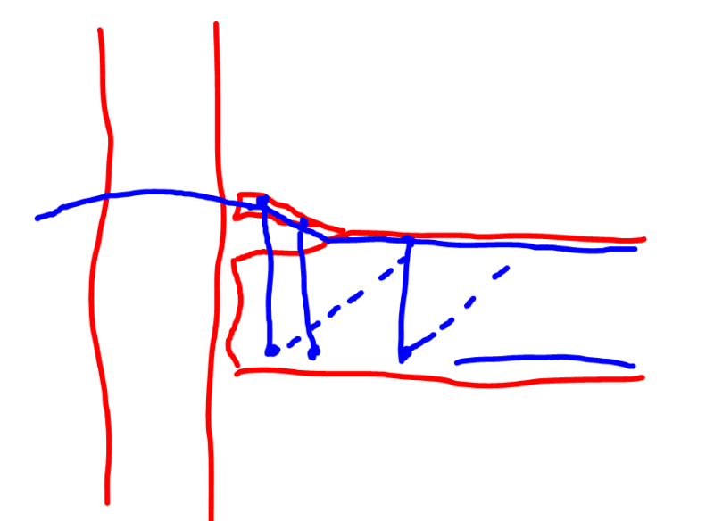

In the sketch below, I've attempted to explain the logic for why the closed stirrups are necessary when the bottom bars are not made continuous. Basically, the beam needs to "hang" from the stirrups and top steel after a hypothetical concrete shear failure. Similar logic applies to a diagonal shear failure.
Thanks! This makes sense. The “or” had evaded me.
