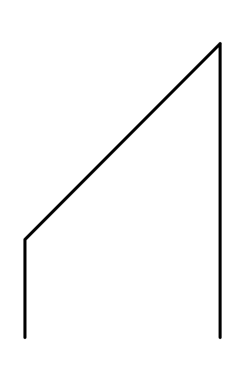

Nevertheless, My previous house did have a high vaulted ceiling in the master bedroom on the second floor that didn't have tension members going across the room, which makes me wonder how that house got away with it. Now, that house actually only had a half-vault, i.e., the roof looked like below, so that might have been an easier do.
TTFN (ta ta for now)
Different scenario. Most of the weight is taken by that vertical wall to the right. It might also be balanced by another roof to the right of that vertical walk.
Thar would still be a horizontal commonsense on the left hand walk but if the angle was less then this might be able to withstand it.
