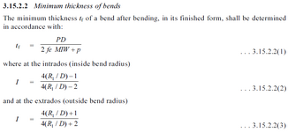

When comparing AS4041 and ASME B31.3, I noticed a difference between the way they handle minimum wall thickness calculations for bent pipes.
Compare the formulas in the following sections;
AS4041 Cl. 3.15.2

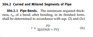

ASME B31.3 Cl. 304.2
AS4041 suggests a larger wall thickness is required in the extrados of the bend
ASME B31.3 suggests a larger wall thickness required in the intrados of the bend
FEA of some sample geometry showed higher stresses in the intrados, suggesting to me that the ASME approach is correct.

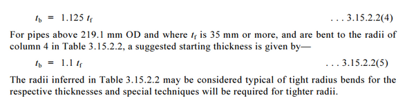

Further, it was not clear to me how to best use these calculated tf values and how they interacted with the formulas 3.15.2.2(4) and (5).
Are these formulas just suggestions for starting points to then be refined through prototyping, in order to satisfy the calculated tf value?

I just had a look, and I'm thinking that the Australian Commitee copied the formula wrong :S, I have come across that before in some obscure clauses.
From a fundamental point of view, the basis of these calcs is that a pipe will try and "straighten out" when subject to internal pressure, and as a result more stress is put on the intrados, and hence the introdos has to be thicker. If you think about the same pressure being applied, there is more area on the extrados, so a force imbalance exists. sounds like your FEA model showed the same thing.

For 3.15.2.2(4) and (5), tb is the recommended thickness of a straight pipe, before you start bending it, during bending is stretches and becomes thinner. it's just a guide so that you don't start with a pipe just on the limits, then bend it and it is now too thin to use.
We have found that bending the pipes will become thinner at the extrados, but actually thicker at the intrados. I wonder if this is manufacturing method dependent.
But for example, if we start with a pipe of thickness "x", the bent pipe formulas would then require min thickness "x+" at intrados (using ASME approach) and "x-" at extrados. Our samples show that when "x" is set to the straight pipe calculated tf, this would also satisfy the bent pipe calculated values. So as far as I can tell, essentially the bent pipe formulas place no additional constraint on the design (in my case at least). Am I still missing something?
This is assuming I can ignore the 3.15.2.2(4) and (5) tb values as just "recommendations" and not requirements.

The following that apparently confirms you observation may be of interest, though I am not a subject matter expert:
1.
Problem with AS4041 formula compared to ASME B31.3 formula.
The intrados should get thicker and the extrados thinner.
2.
KASA Redberq Opinion: The output from the equation shown above for AS 4041 will provide the intrados thickness for the extrados and vice-versa when compared to ASME B31.3. We believe this to be an error in AS 4041. If in doubt, use the ASME B31.3 formula.

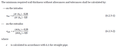

It definitely is a mistake on AS 4041 side. I recently moved to Australia and started to use the AS specs. I am quite familiar with EN and ASME specs and recognised the equation they used as it was copied from ASME31.3 or EN13480 (sometimes looks like they use a combination between the two standards), but they applied the calculated factor incorrectly to the equation. The way they have changed it the Intrados and extrados equations should have been multiplied with "I":
Extract from EN13480:
Extract from AS4041:
Hi Etz,
Thank you for your input, I think it validates my thoughts.
To me it looks like they borrowed the equation from the ASME code but made an error.
The ASME code has SEW/I, AS4041 has feMW*I in the denominator.
The EN code I was not familiar with, it is interesting that it multiplies the whole e equation by the I factor.
Fun how everywhere has these subtle differences :) I will have to explore that approach and see how it affects results.
ASME B31.3
