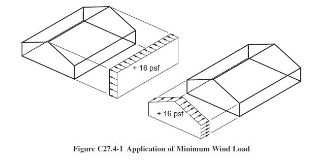

It needs to be applied as it's own separate load case (unless it is obvious that it won't control). The commentary makes this pretty clear:
As can be seen in the image above, it gets applied to the roof as well as the walls, so it may not always be obvious whether it will control or not (as the rest of the roof loads are applied normal to the roof plane(s)) - so it may be easiest just to include it as one of your load cases.
