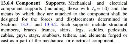

  2. The same sheet metal box is mounted on top of a 2-foot tall HSS frame (total frame weight = 250lb) with diagonal bracing similar to an OCBF, which is anchored to a grade-level concrete slab.
    • ASCE 7-16 13.6.4 would seem to indicate that both the attachment of the transformer to the HSS frame and the design of the HSS frame itself should be done using the Fp forces per Ch13.

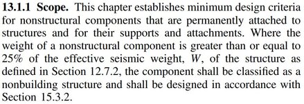

    • ASCE 7-16 13.1.1 says that if the nonstructural component weighs > 25% of the structure, then it should be designed per ch15. (This assumes you can call the hss frame a 'structure').

ref 13.1.1
ref13.6.4
