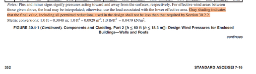

Hi all,
I have recently picked up a copy of "Design of Wood Structures" by Breyer, and I saw something in the Example 2.10 that does not look right to me.
The final inward pressures for some zones are less than 16 psf (which should be the minimum C&C wind pressure).
So, I checked the ASCE 7-16 Figure 30.4-1 and saw that it asks for the final values to be at least 16 psf. Is there any reason why the lower values used in the example?
Another question, why were the outward pressure that are less than 16 psf not shaded? Because they are suction? And is it the reason why the values less than 16 psf used in the examples because they are pushing against the members instead of away?

30.2.2 says 16 psf minimum acting in either direction. I’ve never used Part 2 of Chapter 30 in ASCE 7-16. The lack of highlighting in the negative column strikes me as odd, in the context of your question.

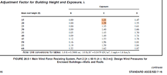

Also, how the heck is he getting 1.22 for lambda? The problem explicitly states Exposure C. 1.22 only exists in the Exposure B column of Figure 30.4-1.
This is what I read as well. As the note mentioned, final values shall not be less than the 16 psf. And that the negative values were not shaded at all.
For this, he actually got it from interpolating between the values in Figure 28.5-1. With hmean = 15.5 ft. 1739741717802.png

Got it. Linear interpolation makes sense. Sorry I couldn’t be of more help!

I just cannot wrap my head around if they were mistakes, given that so many people praise this book. And why ASCE 7-16 doesn't shade the negative pressures in the table!
Is there a chance that the book is working in ASD? If so, the minimum design-level load would be (16 psf)*(0.6) = 9.6 psf.
It couldn't be since I believe all ASCE 7-16 wind load are in strength level.
So if he's pulling the values from the tables, he needs to convert them back to ASD, for which he did not. And if the final values are converted to ASD, those values will still be less than the 10 psf required for ASD.
For consistency, either approach is not following minimum wind load.
