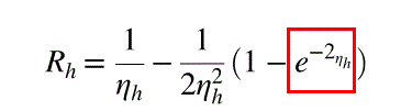

- In the calculation of the Rh/RB/RL factors what does is the significance of the power e is raised to; i.e. 2 subscript nh?

Last item- I'm looking at ASCE 7-16.
Eq. 26.11-15a has a (1 - e^(-2*eta)) term. That is exponential function of negative two times eta, where eta is substituted in at the values shown to get the different R terms.

Is this a misprint; i.e. e^(-2*nh)?

The only issue left is the printing of the equation for Rh etc. Is this a misprint and should it be:
e^(2 * nh)?
