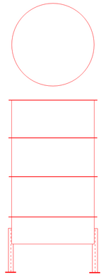

This question has to do with the proper selection of wind load chapter that is to be applied to a silo type structure.
The structure in question is a 50 ft diameter x 100 ft tall cylindrical structure that is open on both the bottom and top (i.e. no floor and no roof). The structure is supported on a number of legs which are simply I-beams with a base plate that is bolted to a concrete foundation. Stiffening rings are located at various elevation to help combat ovalling of the cross-section and excessive circumferential compressive stress. Below is generally how this would look.
Based on my reading and to use the terminology of ASCE 7-16, I would simply classify this structure as a "circular bin, silo, or tank".

The big counterpoint that I have come up with is that the wind load criteria within chapter 29 for "circular bins, silos, or tanks" in seemingly only for structures with closed bottoms (floor plate or ground) and tops (roofs or top closures). Since the structures I am dealing with have an open top AND bottom then there would be a contribution from an internal pressure coefficient - which chapter 30 gives guidance on in 30.12.3 (although it only states for open TOP - not bottom - structures). If I was to use chapter 29, I would use a force coefficient (Cf) of 0.63 and be done with it. If I was to use chapter 30, the magnitude of wind load around the circumference of the cylinder would vary greatly. See below for how this would look.
This variable wind load around the circumference of the shell would make using classical structural analysis (to find the maximum axial, bending, and circumferential stresses at any elevation in the system) either much more difficult or totally unfeasible. The analysis required then would be to do a finite element analysis on the structure to explicitly account for this variable wind load around the circumference of the cylinder.
My goal is obviously to not just do what is convenient from an analysis perspective, but to do what is going to be the most correct method for modeling how wind load is acting on the structure. What do you all think about this general topic and my opinion?
-This description implies steel silo and could be assumed flexible ,
- Your approach seems reasonable . Analytic method should be adopted,
- I will suggest you to look API 650 ( open top tanks ).
- API 650 ( uses WSD) ,proposes min . design wind pressure on the shell PWS= [(18.6 lbf/ft2)(V/120)^2] on vertical projected areas of cylindrical surfaces. I will suggest you this as a threshold value .
- Since the silo is open at the top and bottom, you should provide with a top and bottom wind girder to maintain roundness.
- The location and no. of intermediate stiffenners ( wind girders ) could be selected as per API 650.
