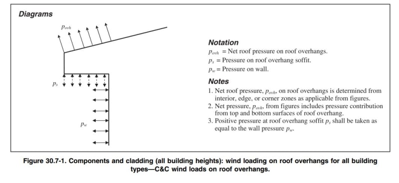

I understand the C&C wind pressure on roof overhangs is the sum of the pressures on the top and bottom surfaces.
The equation in ASCE 7 is p = qh*(Gcp-GCpi) where Gcp is defined as "the sum of the GCp of the overhang's top and bottom surfaces".
By defining GCp as the sum of the external GCp values for the top and bottom surfaces, it appears the intent is to cancel out GCpi. If GCpi were to be included, it would apply to each surface and should be combined appropriately with the corresponding external GCp. Then the pressures for each surface would be combined after that. Furthermore, in no case would it seem appropriate to sum the external GCp values and then apply the GCpi value singularly.
Also supporting that this may be an oversight is how poorly conceived Figure 30.9-1 (7-16) is. Looks like this figure hasn't been touched or the supporting text cleaned up since someone sketched it initially. This points to a lack of attention to this code section.
This seems very clear to me, but if so, why has this persisted from 7-10 to 7-16 to 7-22 without revision?
This thread asks the same question and did not get any traction. The one response essentially agrees with cancelling GCpi (the carry-on thought of including Gcpi for designing the cladding is analogous to calculating the pressure for a single surface).
I agree that inside an overhang, the internal pressure will push up on the roof and down on the soffit. Thus, the two GCpi values cancel each other out.

ASCE 7-22 30.7 clarifies this a bit. Cladding only needs their adjacent GCp value (top surface to roof, bottom surface to wall). Components that support both surfaces would need the combined GCp. I would use a similar approach to the internal pressure as the parapets. The internal pressure cancels out when using the combined GCp. In 7-22 with gables greater than 7 degrees, you end up doing this anyway.

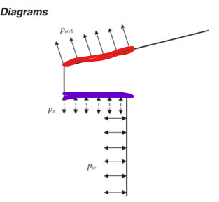

Lex - when the overhang is taken as a whole, the first surface is the roof and the second surface is the soffit. Each surface would have an external and internal GCpi. Cladding forces are calculated from a single surface standpoint. External and internal GCp would apply to that surface. This is not what I am asking about.
I don't see when the "sum" would apply. Component and cladding loads for the roof (with internal pressure) apply to the roof sheathing, the component and cladding loads for the soffit (with internal pressure) apply to the soffit.
What are you designing where there's two cladding loads? If there aren't two cladding loads, how are you getting two "different" GCpi that potentially cancel out?

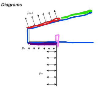

The sum would apply when you are looking at the attachment of the roof framing to the superstructure, say a roof clip on a wood truss (shown in pink below). The sum I am referring to is the roof pressure and soffit pressure on the overhang portion, which both apply when looking at the demand at the roof clip.
Right there you've stated there is a GCpi for the roof and a GCpi for the soffit. Those are the two GCpi that I believe cancel out (for the condition of checking the roof clip). They are different in sign only.
That's my point, if you have cladding pressures from more than one surface, I don't think that's cladding anymore.

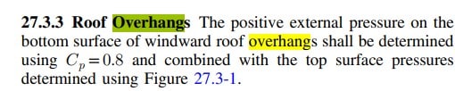

In the MWFRS case I'd look at if you have a separate space, so a stud wall could hypothetically be depressurized while the attic could be pressurized, though it seems unlikely, but then again, there's roof ventilation and the stud wall typically isn't ventilated. But if both the wind loads are affecting the same interior space (e.g. the attic), and there's no vapor barrier between them, I would think treating the GCpi as effectively zero would be appropriate from a statics standpoint, because they exert pressure in roughly opposite directions. Come to think of it, though, the overhang gets a MWFRS Poh, which I think combines the soffit load, so you're likely including one GCpi (that might not actually happen) to increase the calculated uplift, which is conservative.
There's a lot of commentary in C30 on overhangs, but that's for C&C loads.
