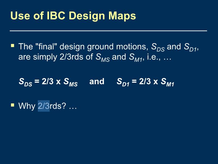

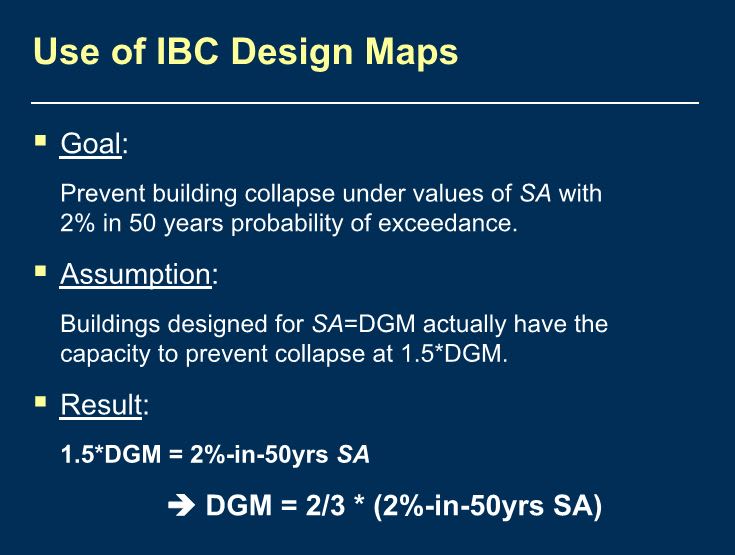

NTUCE said:I'm a bit confused. So in UBC code, when MCE occurs, the building designed with DBE will use up all it's ductility and then collapse?
