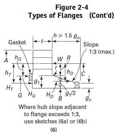

Hello,
I might just be blind as a bat, but I can't find anything in ASME B16.5 that specifies the required radius on the backside of a RFWN flange. I've highlighted the radius in question below:
Does anyone know what this radius should be?
Cheers,
Marty
marty007, no more so than me :)
I cannot find anything on it. Odd
Well that diagram is really to define something else, but I agree it doesn't specify it.
Looking through B 16.5, 3mm radius seems to be the default radius where it is specified in general as opposed to a specific one like the inside of the ring groove.
Ask a vendor?
Or just specify it.
You'd think there'd be a statement something like "Dimensions not shown shall be the manufacturer's standard".
I find it interesting, because ASME B16.47 specifically addresses this radius in their flange dimension tables. It varies between 3/8" up to 15/16" depending on the flange size/class/series.
These flanges are going to be used in an ASME VIII-1 vessel, so I think I'll just follow App.2 guidelines...
Cheers,
Marty
