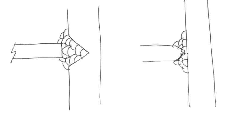

Quick question: what type of weld is this (girth, longitudinal, branch, attachment, etc.)?
Carbon steel 1” semicircular plate, full penetration weld, inside of carbon steel tee, 2” wall thickness. The code is ASME B31.1. Process fluid is steam.

double sided fillet weld
DHURJATI SEN
Kolkata, India
The original post said it was complete joint penetration, so it can't be a double fillet weld. Fillet weld must be fused to the root, but they are not required to penetrate beyond the root into the joint.
I don't believe the post was asking whether the weld is a fillet or a groove weld, but whether it was circumferential or longitudinal or girth, etc. Circumferential and girth welds are typically butt joint. This application appears to be simply a groove welded T-joint with reinforcing fillet welds using AWS terminology. Still, I don't think that was the real question in the original post.
Best regards - Al
It's a full penetration non pressure attachment weld. Of all the numerous B31.1 power piping designs I've seen, this one is definitely new to me.
Putting the weld prep in to the wall of the tee does not seem right. Why not prep the edges of the plate?

yes, it is to straighten steam flow and reduce pressure fluctuations. This is one tee in a header with 3 inlets and 2 outlets. It is an existing system.
that's my bad on the sketch part - the plate is prepped with a double bevel grind, while the interior of the tee is just cleaned up. My poor attempt to show the full penetration weld.

I was questioning the design of the weld of the plate to the inside of the tee. Seems not a good idea to cut a groove in the fitting and then fill this with weld and then weld the plate. Why nor prep both sides of the plate only.
Answer: Tee Joint weld /Non pressure part attachment joint
Mateeng,
How can it be a " non pressure part " when it is welded directly to the pressure retaining wall of the Tee ?
