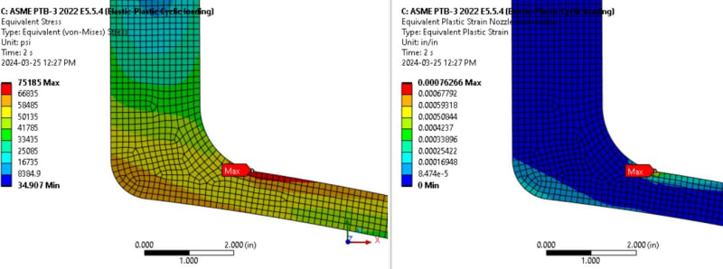

I have a question regarding ASME PTB_3 Example Problem 5.5.4 (Elastic-Plastic stress Analysis):
In Table E5.5.4-3 the values of Equivalent stress and plastic strain range doesn't match with the Figures E.5.5.4-2 and 5.5.4-3.
Am I missing something here? How the values of Equivalent stress and plastic strain range are different in Figure and Table.

However, if you see following table. The Table E5.5.4-3 is taking a lower value of Δεeff,k.
I created a FEA model and can confirm the location of ΔSp,k & Δεpeq,k is same as given in the Figure E5.5.4-2 (See below).
So, if the highest value of Δεeff,k are of interest, then ASME shouldn't have used the values given in Figure Figure E5.5.4-2?
See STEP 5 of the example.
The areas of interest are the nozzle inside radius, head knuckle , and the shell.
The maximum values of ΔSp,k & Δεpeq,k which can be seen in Figure E5.5.4-2 does produce higher Δεeff,k value but does not occur in the nozzle inside radius.
The Figure E.5.4-1 shows the overall value of ΔSp,k & Δεpeq.
Figure E.5.4-1 shows ΔSp,k & Δεpeq at nozzle inside radius which is also the maximum values.
Even If we agree the Figure E5.5.4-2 is not for the nozzle inside radius. ASME should have considered the maximum ΔSp,k & Δεpeq value (from Figure E.5.4-1) for the overall fatigue life calculation. Since that would be most conservative life. However, I do not see anywhere in the Table E5.5.4-3 that most coderivative case has been used.

Figure E5.5.4-1 shows the von-Mises stress and the equivalent plastic strain of the entire model but only 3 locations within the model was analyzed: the nozzle inside radius, head knuckle , and the shell.
Figure E5.5.4-2 shows ΔSp,k & Δεpeq at nozzle inner radius, there are other areas in this figure which shows higher ΔSp,k & Δεpeq value, but those area has not been analyzed in the example as they are out of the area of interest.

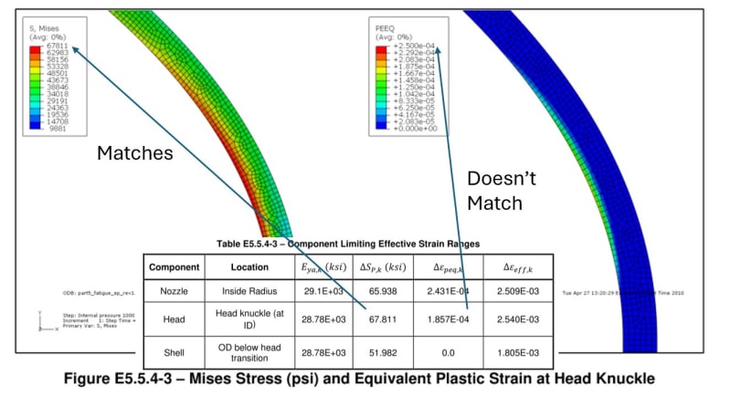

Figure E5.5.4-3 shows result specifically for head knuckle.
The ΔSp,k value matches however Δεpeq doesn't match at Head Knuckle (ID).
What is the explanation here for no match between Table E5.5.4-3 and Figure E5.5.4-3 for plastic strain of head knuckle ID.
**I can confirm from my FEA that both ΔSp,k & Δεpeq are at same location**
The value of ΔSp,k in the head knuckle is 67.811ksi, that is clear and can be seen on the figure by the red color which meets the legend.
The Δεpeq in that location (where ΔSp,k=67.811ksi) is not 2.5e-04 since the legend shows it has a green color which matches the legend.
