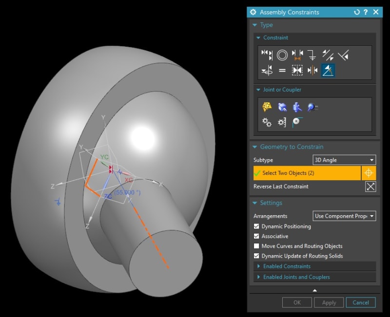

Can anybody give suggestions for constraining the ball end (with thru hole) to the rod end?
The thru hole in the ball needs to move in the spherical path of the ball it is part of.
I am not concerned about the zinc-colored threaded part.
Jerry J.
UGV5-NX1899

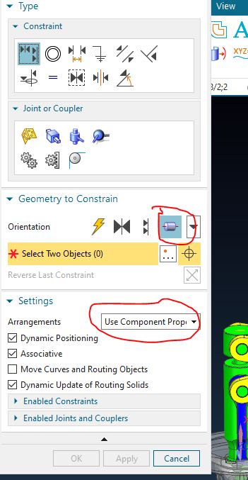

Or Align using 2 points, each at the center of the spherical faces.
Mike

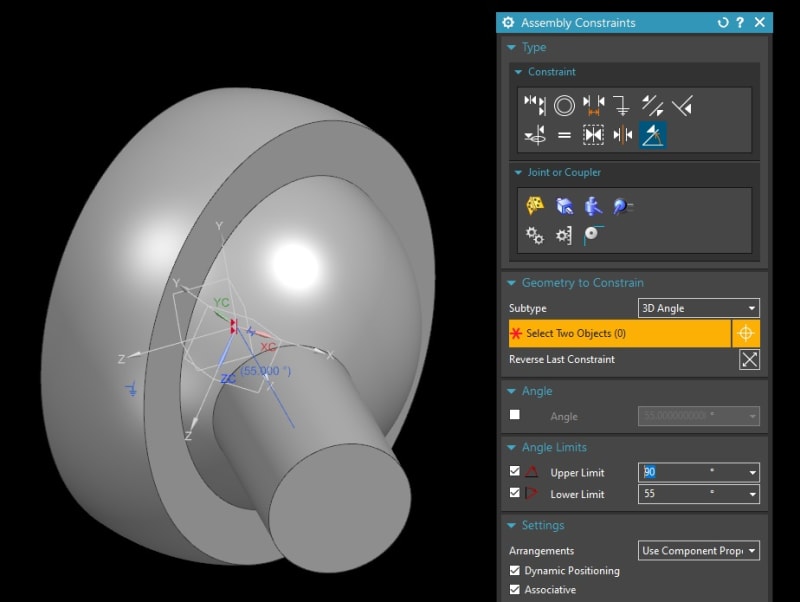

As above, with angle constraints with angle limits:
cowski method is better when You want change position of ball in outside assembly.
Best regards
