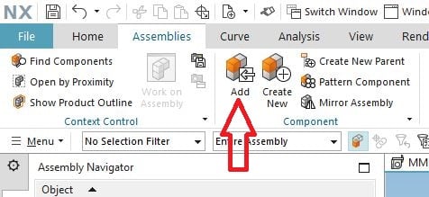

I am back after a long time. I want to know the exact procedure to save the assembly files in NX.There are a lot of options which is pretty confusing. Also want to know the settings that need to be done for the assembly workbench.
What is the difference between launching the assembly workbench with Model and assembly. Both appears to be same.
What version of NX are you on ?
Technically there is no difference between an NX Assembly file, and an NX model file, but you may have templates set-up for them separately.
When working with assemblies the Assembly module should automatically turn on.
To create an assembly start with a model file and add components using "ADD". Assembly Constraints are very similar to other CAD systems.
