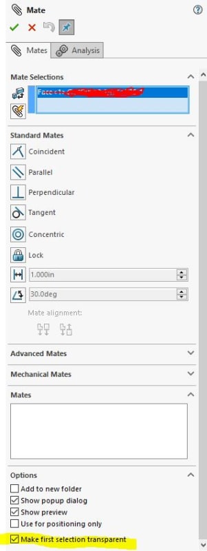

I haven't found an answer through search, so I thought I'd ask. SolidWorks 2019. When I select a component to mate in an assembly, it changes to transparent. I changed this in earlier versions to keep the component color but haven't been able to figure out how to do this in 2019. Any suggestions?

During Mate, scroll down to bottom of tree, uncheck box.
