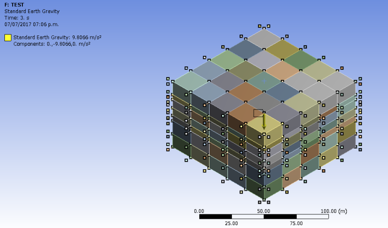

Hello,
Is it possible to assign the same command code to several geometry parts or elements? For instance, I would like to add the Drucker-Prager code to several elements Or add the Damping and string coefficients for several beam elements(like adding COMBIN14 element)
60a46a7f-d69c-4dae-ab34-7e7ceb21e8955gec8ad4dab-8458-4026-b4d1-3a6889d39f14_mg7trx.png
7c627ba3-821b-4cdf-9350-1f2f48700e339vf819be8b4-2744-4933-bece-a2db4fee6744_kxtew6.png
Thanks!

Your geometry looks very orderly. Would you be able to select the elements via NSEL location filters, then ESLN,S,1? EMODIF could then be used to get your desired parameters.

I converted my beams into rigid beams in similar tree just inserting commands once.
I only add to the first beam and then RBM on the command in tree, copy and paste below. And again, and again.
Im unable to check it right now but Im sure it looks like i described.
