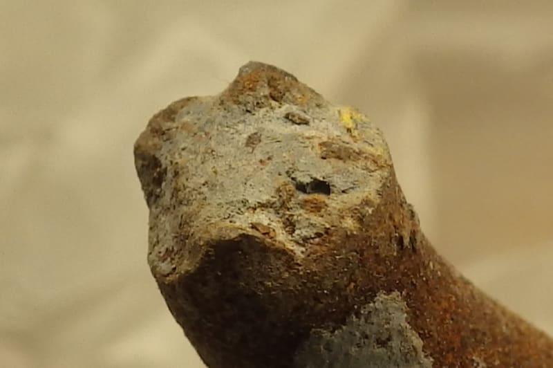

Hi all, long time since I posted on here

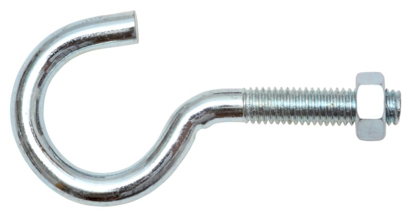

I have an application that uses a hook to hold a load in a tensioning spring system.
The weight of the load is max 10kg but the tensioning system and the service could add a maximum 100kg.
It will see cyclic loading with maximum swings of perhaps 30-100 kg roughly 500000 times over 10 years.
Application is at 150-180°C (300-350°F)in an air environment. Corrosion seen before has been medium to normal, not excessive.
A 5/16" thick carbon steel bent wire hook bolt (cold rolled A1008) is more than strong enough for this, on paper. (yield 40k psi - 5/16" ~12000lbs / 5500+ kg)
Fatigue shouldn't be an issue as we don't approach anywhere near even 10% of the yield strength in the cycle...

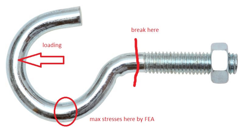

Instron tests have the hook being able to hold 300+ kg before a bending open of the hook starts. 3x possible max loads.
However we had a failure (1 out of roughly 500 installed) after just a few years of service.
The hook snapped... straight snapped under the hooked section of the bolt with no necking at all... looks like a brittle failure, and the hook section was not bent out of shape at all so loads below 300kg caused the break...surface corrosion was visible but not excessive.
How could this occur, some sort of temperature aging ?? or embrittlement ? I thought aging at these temps wouldn't really occur and would require decades to lower the yield only slightly...even so why didn't the hook bend open before yielding?
We are looking to "upgrade" the bent wire hook bolt to an ASTM A489 carbon steel eye bolt, but the ASTM states it has a 275°F (135°C) temp limit.
Does anybody know why ? and could this be related to the previous failure ?
Thank you!
