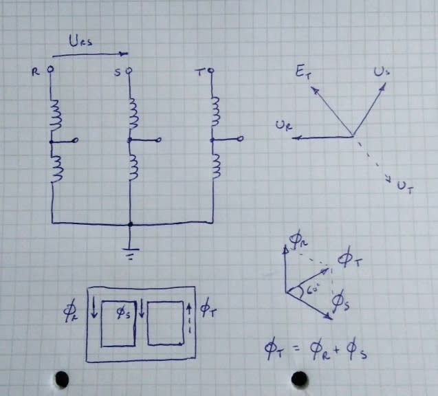

The way I understand the question is that you feed the autotransformer on two HV phases and LV it's unloaded. Is this correct?
For the 1rst case (without tertiary), this is what I come up with:
U representing source voltages and E the induced voltage (emf).
The voltage induced in the open phase (T in my sketch) will be equal in magnitude as the other phases but rotated 180 degrees from what it should be.
I'm still not sure what will be the effect of the presence of a delta tertiary (2nd case). I need to think more about it.

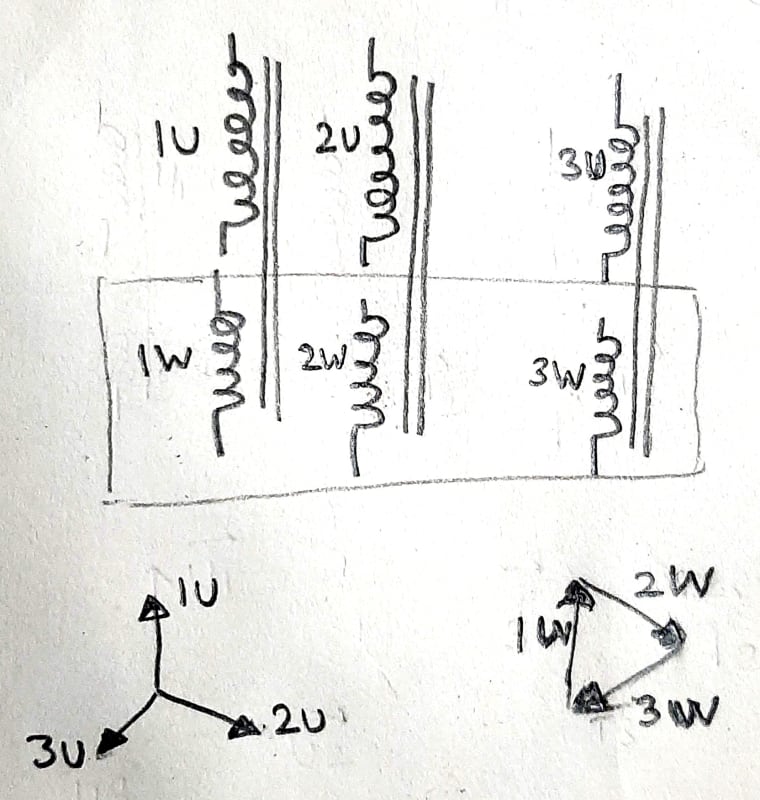

IMO with tertiary winding, resultant of emf induced in tertiary winding of two healthy phases will be equal to flux produced by third winding in case of healthy condition. This EMF will lead to appearance of healthy voltage in all windings of transformer.
In the image below, say voltage at 3U is missing. Resultant of EMF induced in 1W and 2W would be equal to 3W. This will lead to development to voltage in 3U.
You are 180 degrees out.
The instantaneous fluxes in each leg sum to zero and the instantaneous voltages in each phase sum to zero.
The three legged core forms a "Phantom Delta".
The delta, real or phantom, replaces the missing phase.

in all practical cases, if the neutral is grounded, the voltage on the "open" phase will be equal to the expected voltage on that phase, i.e. 1 p.u. with a +120° and -120° shift with respect to the other two phases.
Due to the 3-limbs arrangement, both with and without a delta tertiary, the vectorial sum of the two flux of the connected terminals is equal to the flux on the third (unconnected) terminal.
The same applies for the voltages induced by the aforementioned fluxes.
In practice, both if you have a stuck CB pole or not, you will find the very same voltage to ground on the EHV and HV terminals: it is the same behaviour used during induced voltage tests on YNa 3-limbs units.
