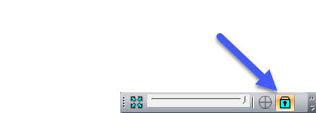

Hello,
I really need help guys, Im having a problem with my autosprink software.
I cannot use "shift-middle mouse" to pan. There is also a logo at the bottmm right and it seems the drawing space is lock
See pic attached)
the mepcad forum board hasnt yet approved my request to join their forum, i really need to finish something immediately,
does anyone know how to fix this? thank you in advance
I believe you have 'locked' your clipping slider.
Find the toolbar shown below and click on the 4 arrows.
Actually I believe it's the other icon (lock) that you'll have to click to unlock.
Thank you TravisMack & Cidona,
Its actually called Focus on Point i didnt realize that button exist at all
Keep safe guys and thank you so much again
