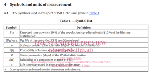

Well then you have ISO 19973 -1:2015, IDT
Pneumatic fluid power — Assessment
of component reliability by testing —
Part 1:
General procedures
We are using the same standard for reference.
Only confusion is "B10 - EXPECTED TIME AT WHICH 10% OF THE POPULATION IS PREDICTED TO FAIL" means scenario A (or) B.
Thank you.
